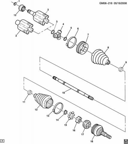

I have had the inner joints on the axle shaft make a wobble under load. It's not very easy to see a worn inner joint.
What happens is the inner joint normally plunges back and forth with normal driving.
If there is a worn spot on the inner joint the slide catches the worn spot and it pushes the shaft one way or the other witch give you a wobble only under a load.
The only way I know to check it is to look for looseness between the shaft and the inner joint when turning the shaft by hand. The front wheels need to be off the ground.

Here is a exploded view of the axle shaft.
