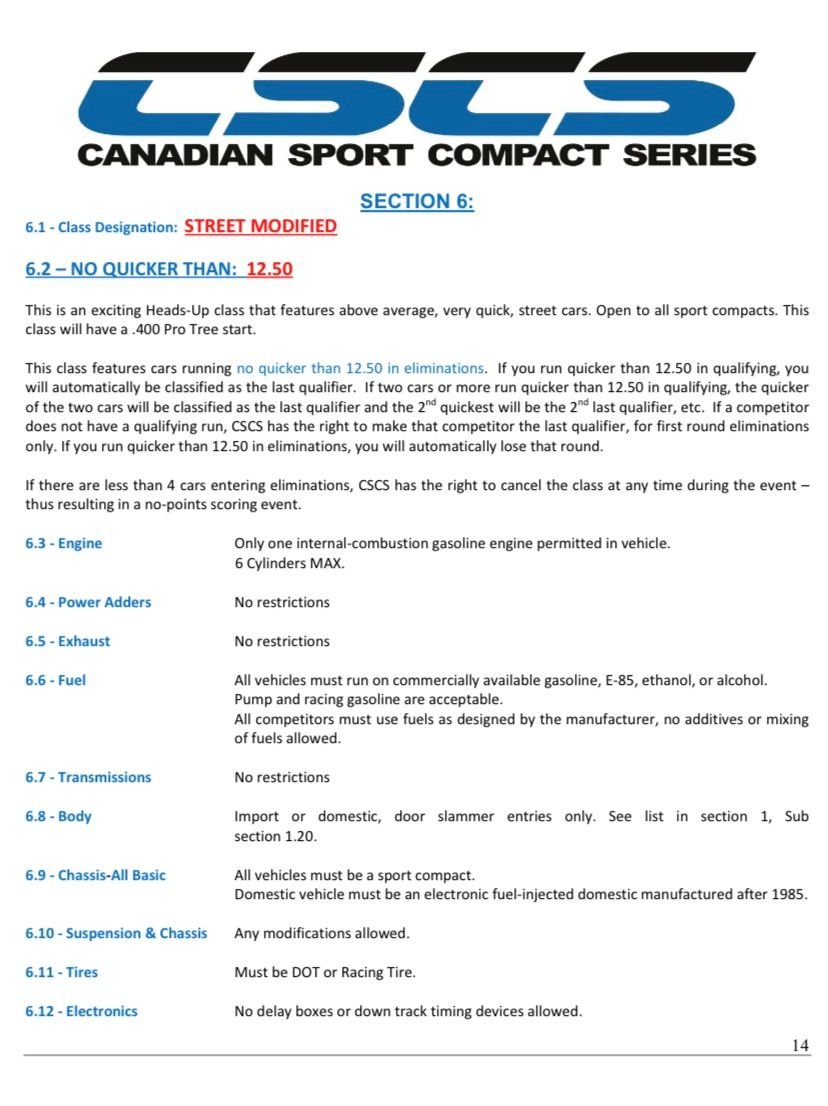

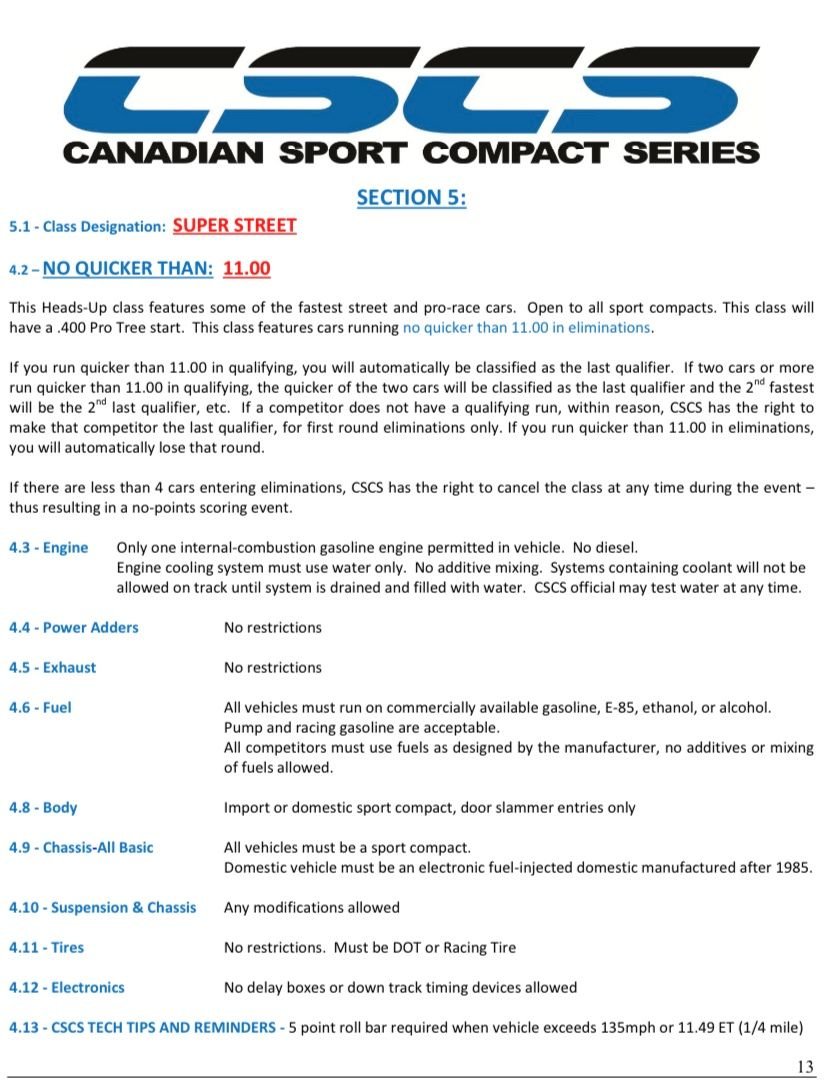

So I’m getting ready for the first season after my rebuild and I’m thinking about entering street modified for the first event while I’m getting used to running slicks. Do traction bars make that big of difference? With enough seat time it should be just as competitive in super street. It looks like I’m going to need to get a roll bar made too.
Is anybody else doing any drag racing this year?

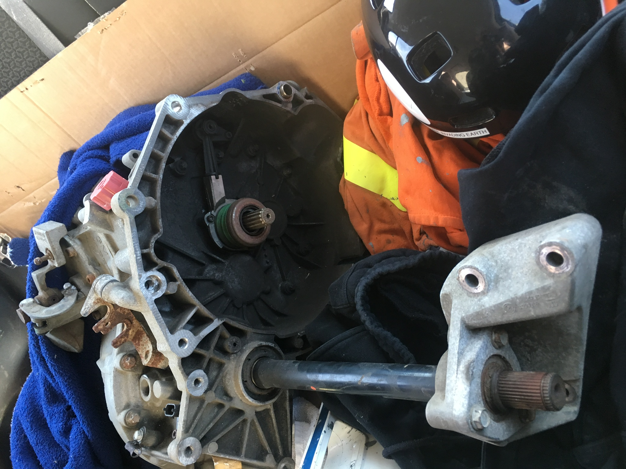

The Saturn vue with the 5 speed and 2.2 came with an intermediate shaft, so using that shaft, we just need axles. One male and one female, but DSS said they’d make me a set for $800usd. My daily driven hhr makes more than 450hp at the flywheel

From what I'm understanding the intermediate shaft is an extension from the trans so now both axles are the same length.
How long is this extension ?
Does it need a support ?
Are you spelling Saturn vue correctly ?
Want to see a picture of it.

Yes, it bolts into the block, there’s holes for them on every ecotec block

Again I'll quote Einstein.
"Now I see as the blind man picked up his hammer and saw".
That was Shaul Einstein not Albert.
