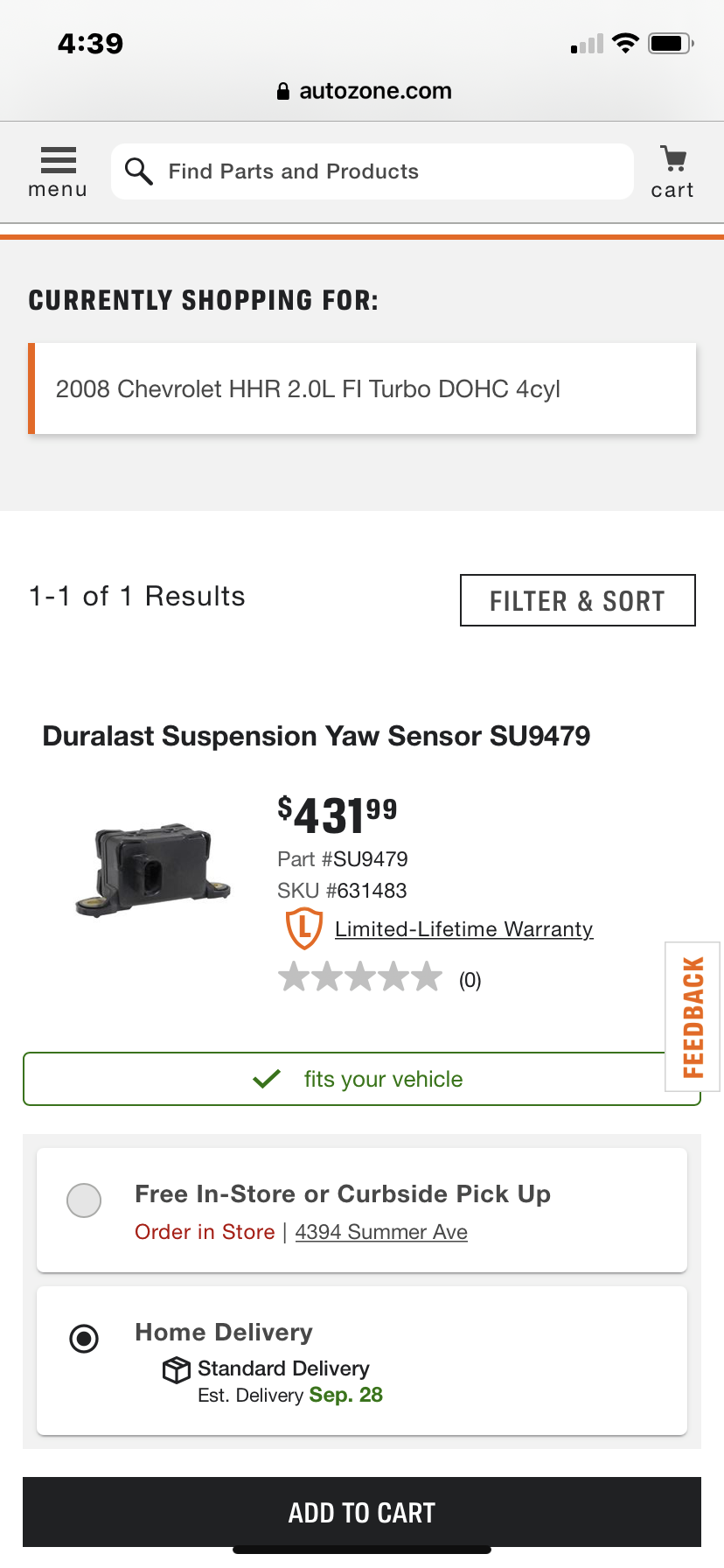

Yes, double check the wiring , it should be on the floor pan under the console or front seats
I found this from Auto Zone
Old Sep 26, 2021 | 03:54 PM
Posts: 26,532
Actually it is next to the console just behind the passenger seat front support.
Old Sep 26, 2021 | 04:50 PM
Posts: 40,082
From that photo, is it possible a drink could have been spilled and got the sensor wiring wet?
