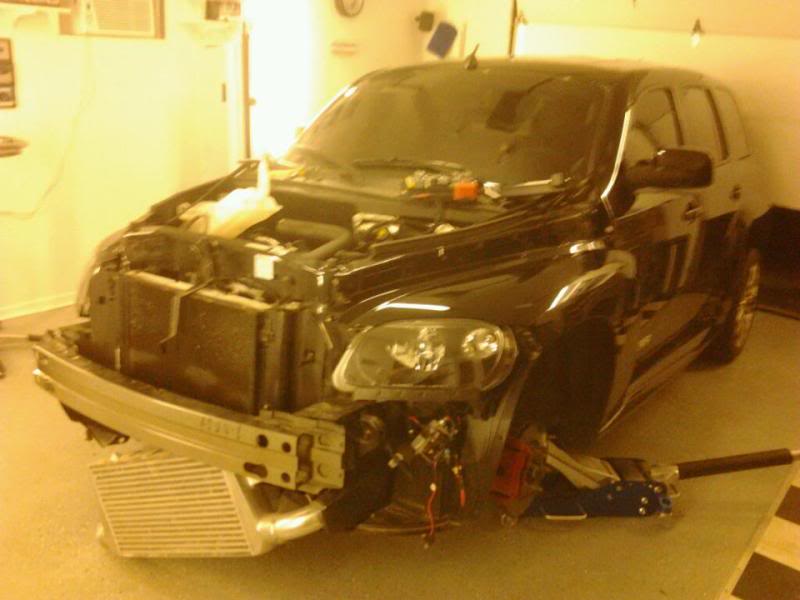

VERY different for the SS crowd. You'll have to remove your coldside pipe to access the TB.
You'll have to remove the bumper, intercooler, and you'll have to remove the 2 mounting brackets that hold the radiator in. Once you've done that, move the radiator out. Now....you should finally be able to get the coldside pipe out and see the TB.
Other people might do it a little different....but I found this is the best and safest way

Tons of fun Sam! Trust me...I'm in the process of doing it all right now. I just installed the brand new harness....just waiting on my cold pipe fomr ZZP. This is the pipe your wanting: http://shop.zzperformance.com/store/...oler-Pipe.aspx
Here is just a preview of what I'm having to do to install the new wiring harness and coldside pipe:

I went and talked to my dealer, they said they would install the harness if I got it. Maybe I'll talk into putting the pipe in. Without it we are subject to rub. Nice intercooler you have there, where did your hood go ??
Awesome! I managed to get my harness for "wholesale"...which cost me $299.00 in a box. I was told it would take anywhere from 4-6 hours to have a dealer install it. So...I decided to tackle it myself. It took me about 5 hours....so I saved some money there. I started removing the harness and noticed it was really dark....even with lights. So.....I had a brain fart and thought...."it would be alot brighter if that hood was gone". Took it off myself. Four 13MM bolts...and it was off! And I could see everything

Actually,back in my mechanic days,that was true. We used to take off the hoods of customers cars a lot of times. On bigger jobs it made it easier to see and gave you more access room. Plus, no more bumping the back of your head when working from the sides of the engine compartment.
