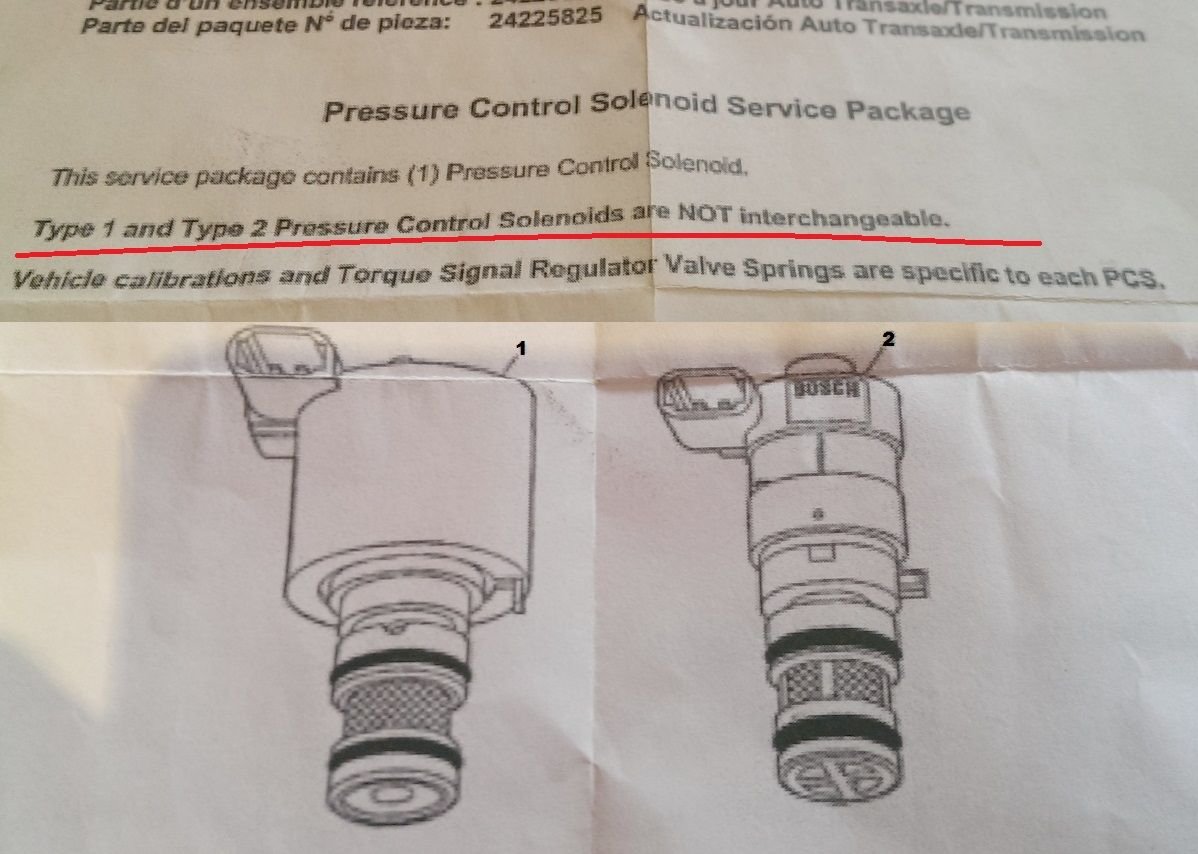

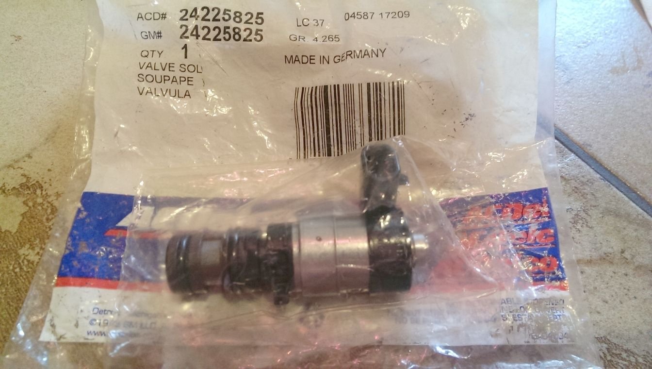

I ordered the parts and they come this morning
But this peace below I´m not sure
because of this notice
can anyone confirm that the second one is the right part?
Old Aug 15, 2019 | 08:31 AM
Posts: 40,082
That looks like the part picture #2. I can’t confirm what’s in your transmission, hopefully not the #1 part.
at least you know , if they are different, don’t install the new one,
