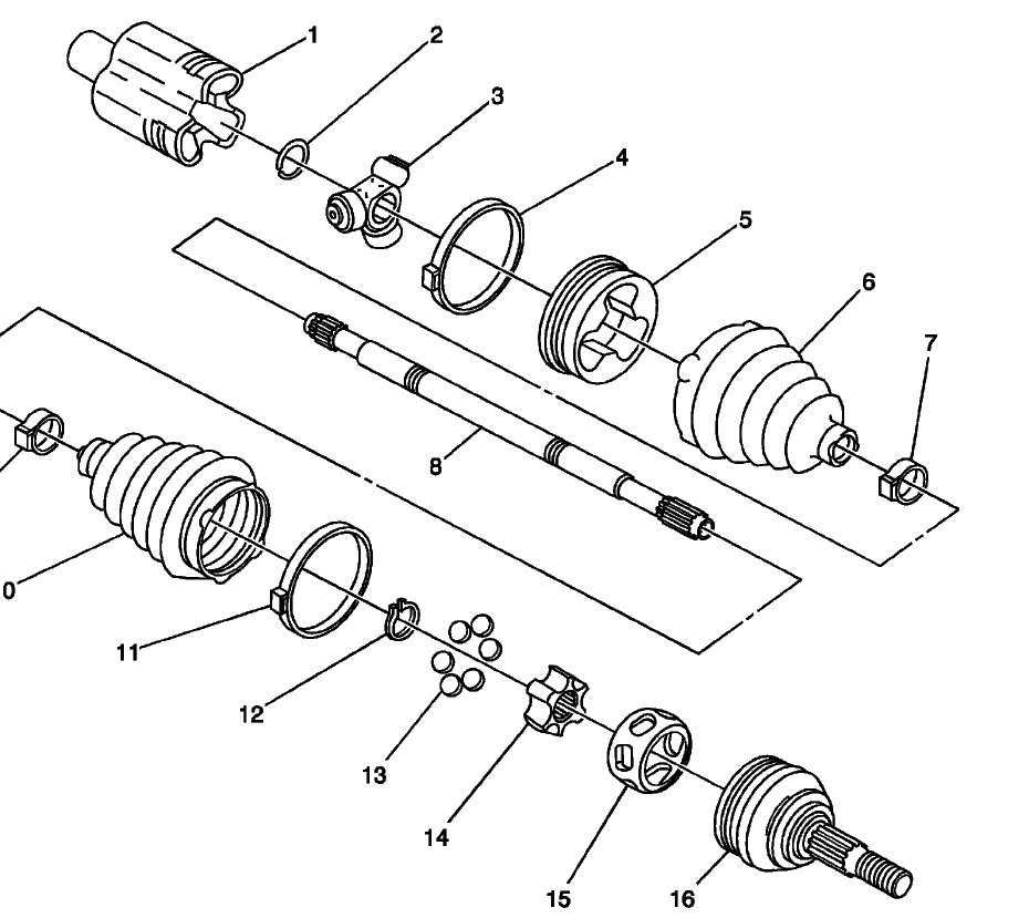

It is called a "tripot". It is basically 3 rollers in channels to form a slip joint that also has a bit of flex.
You say you read that thread and it was no help? What about the "GM8206" suggestion? The parts books say not compatible, but a owner has them installed. IIRC, they are listed for Malibu, G6, Aura etc. I don't know why they wouldn't be the same.
Sometimes you have to lie to the counterman. Take a tape measure with you to check measurements, remember the tripot is a slip joint, so you have a little wiggle room.

Did you see the drawings I posted?
The pass side has a stub, I doubt that is your problem; I have operated without that tiny end bit; it only seals the seal.
There is supposed to be a few inches of end play in the slip joint or you could not drive over bumps.

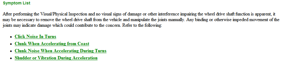

What exactly is the symptom you are throwing parts at?
Here is the beginning of the CV diagnostic procedure:

Well now I'm beginning to second guess my initial diagnosis as the cv axle appears to be fine aside from some oil/grease grime. Boots aren't torn and the joints seem to move without any sort of issue. What I am experiencing is a loud humming noise that sounds like a lifted truck tire. It's constant, just getting louder with speed. I'm beginning to lean towards the hub bearing but like the axle I'm pretty much ending up at g6/malibu/aura hubs. I ordered one already so hopefully will resolve this issue by the weekend.
