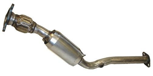

I thought all cars with OBDII had an up steam o2 sensor and a down stream o2 sensor. Here is a pic of an hhr convertor you can see the port for the down steam sensor.
I believe you're correct. The one before the cat is to adjust the AFR, the one after the cat is to make sure the cat is working.
