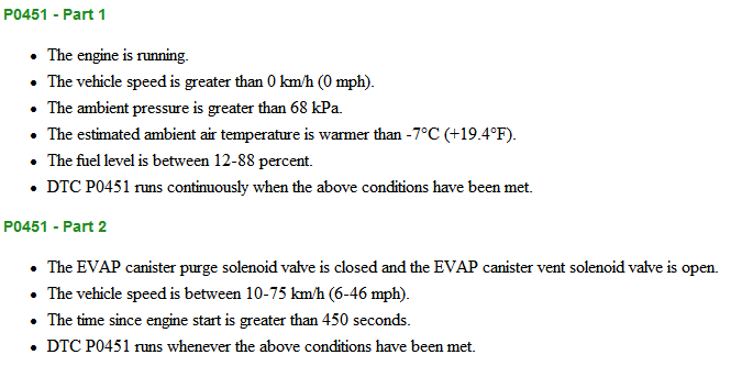

P0451 inhibits both tests. Conditions for running the EVAP include between 1/2 and 3/4 tank of gas when you park it for the day then it runs overnight. It should run after 7 cold starts.
here are the conditions for P0451:
And a pdf of the entire article.

The only thing that doesn't seem to match the description of when P0451 gets set is that the fuel level is between 12-88 percent. I filled the tank, and then erased the codes. After driving a couple of miles I pulled over and read the codes. The P0451 was now pending again. Maybe the P0451 test occurs all the time, but only sets the MIL if conditions are met? That would explain why the code is pending but never actually set the MIL since I made sure the tank was always above 90%.
I will do the sensor electrical tests described in your pdf and replace the FTP if necessary. However, since this is a sensor "performance".code and not a "stuck high or low" code, that implies the sensor may be good but one of the other causes (EVAP canister plugged or sensor reference port plugged).
Maybe I will replace the FTP sensor since its not too expensive and then if that doesn't solve it I will take it in to a mechanic with better scan tools that can do some of the tests described din the article.
