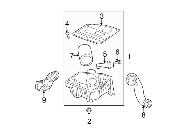

Outlet Duct
Hey All,
Another question for you all. The outlet duct (P/N 1509461) has some damage to it and may be causing my P2178 CEL. It is #8 in the diagram below. I see some have used dryer ducting for the 2.2/2.4, non-SS models but only on the intake side. Do you think the dryer ducting will work on the outlet side? A new OEM duct is $100.00???
Let me know your thought on the dryer ducting for the outlet side.
Thanks,
-Ron
Outlet Duct - Part #8

I would not replace it with dryer ducting.
It does not connect to the TB, that is the turbocharger on the other end of the duct.
This duct is not subject to positive pressure(boost), so I would try patching it, or covering it with plastic, a piece of rubber hose, duct tape.
Maybe a picture would help us make a more specific suggestion
EDIT: if it's in the flexible, accordion part of the duct, it will be very difficult to repair. Probably impossible if on the bottom of the duct, where oil from the PCV system collects..
