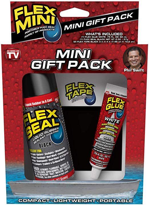

If the plastic is cracked or the rubber perhaps this would be a temporary fix to confirm that caused the problem. The order the part, perhaps someone has one in the spare parts area of their garage.

I would not replace it with dryer ducting.
It does not connect to the TB, that is the turbocharger on the other end of the duct.
This duct is not subject to positive pressure(boost), so I would try patching it, or covering it with plastic, a piece of rubber hose, duct tape.
Maybe a picture would help us make a more specific suggestion
EDIT: if it's in the flexible, accordion part of the duct, it will be very difficult to repair. Probably impossible if on the bottom of the duct, where oil from the PCV system collects..

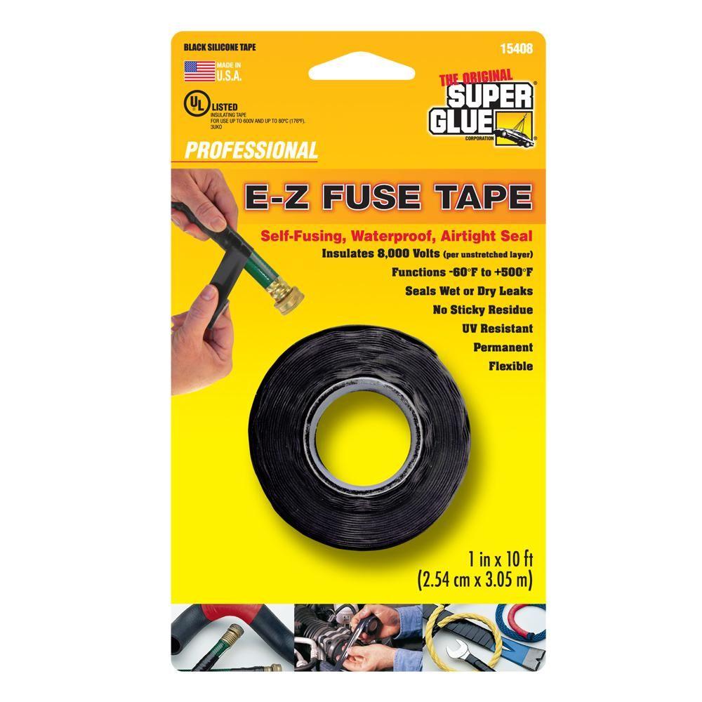

If the split is there I have used this tape for flex joint repairs.
Bought it at Home Depot.
Area must be clean and dry. Pull tape as you wrap it. It sticks to itself and very flexible.
Your hands should be free of oil and grease also.
The instructions do say wait 24 hours after wrapping to let the tape bond completely.
Read up on this stuff.

Yes. There is a strip of rubber missing and only half of the clamp has rubber under it before clamping to the turbo.
I will research this product. This may be the fix I need?
Thanks
