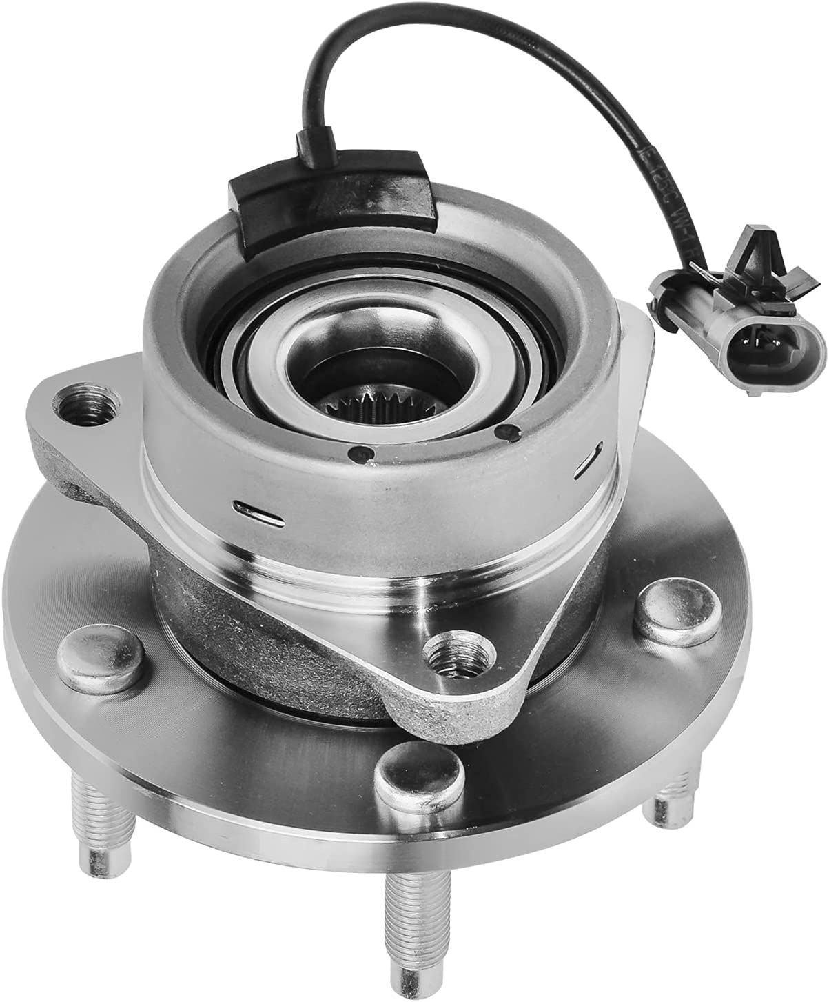

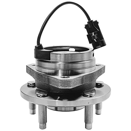

If you pulled and stretched the wire from the ring on the hub, then that potentially could be an internal break in the wire and you would not have enough room to repair it
As we see here the wire goes into the ring on the hub inside of the rubber on the left
Another angle to view the ABS part of the hub. These 2 photos are of LS/LT hubs .

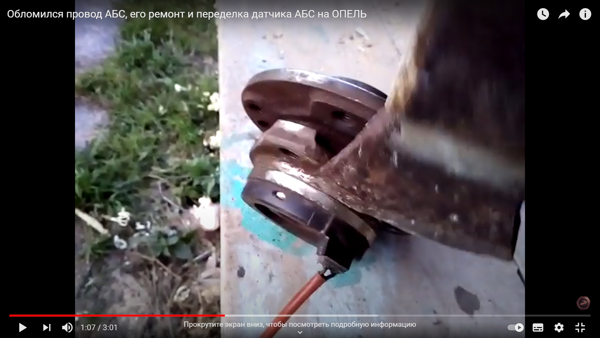

On the net, I found a guy who restored the ABS wire on the Opel Astra. (There are probably no Opel in the USA, but this is also GM, and Astra is pretty close to ННR). He writes that he simply removed the hub, dismantled the ABS sensor, found the break in the insulation (the wire simply rotted from moisture at the break), and then cleaned the problem area from rust and insulation, soldered the missing piece of copper wire and isolated the repaired place. Everything is clear from the pictures.
Here's a link: https://www.drive2.ru/l/479610821400330370/
just before removing the ABS sensor - mark the normal position with a marker.
After repair, the sensor must be returned to the same place.
To remove it, you need a vise and something to pick it up (I used an ax). To return to the place ... in short, you need to press it in. Perhaps using a wooden mallet will work too. I did not put my sensor back in, my car is without ABS.
