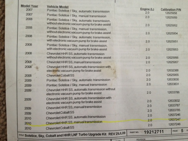

Here you go big jack. Ignore the highlighted one, that is for my car.

Xtreme ss thanks for that Info I do have those series of numbers but there is some other series of numbers that Gm is using at the dealer
they showed me on paper both numbers used but the numbers did not appear to be anywhere near the series of numbers in the instructions.

Ya there is a few different #s associated with the kit. You have the flash part # which I provided above, your kits serial #, a gm case #, and I believe there is one more.
