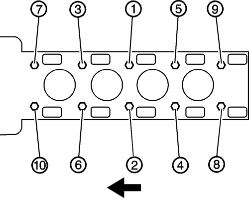

Torque sequence
Hello im putting the head back on and would like to know if anyone has a torque sequence for it. I cant find it online.

Posts: 40,083
Old Oct 15, 2019 | 12:34 PM
Posts: 40,083
https://www.chevyhhr.net/forums/how-...e-items-54648/
https://www.autozone.com/repairguide...96b43f80cb2e47

Fantastic! Thanks old blue!!
