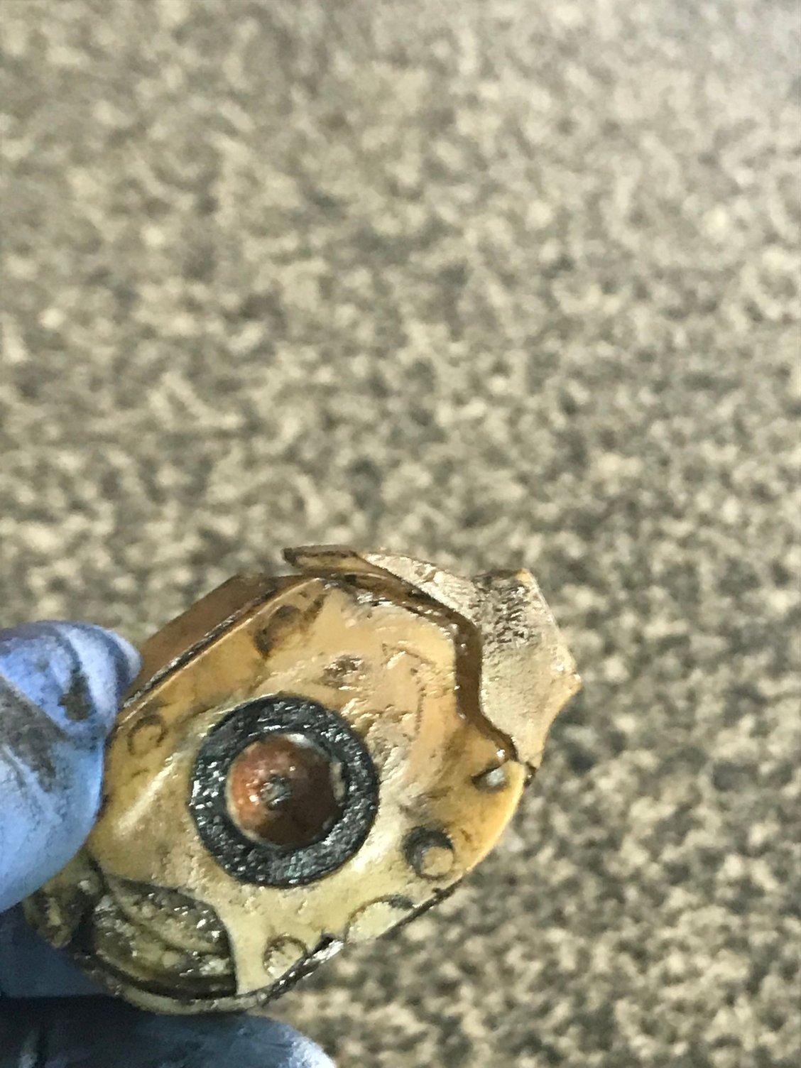

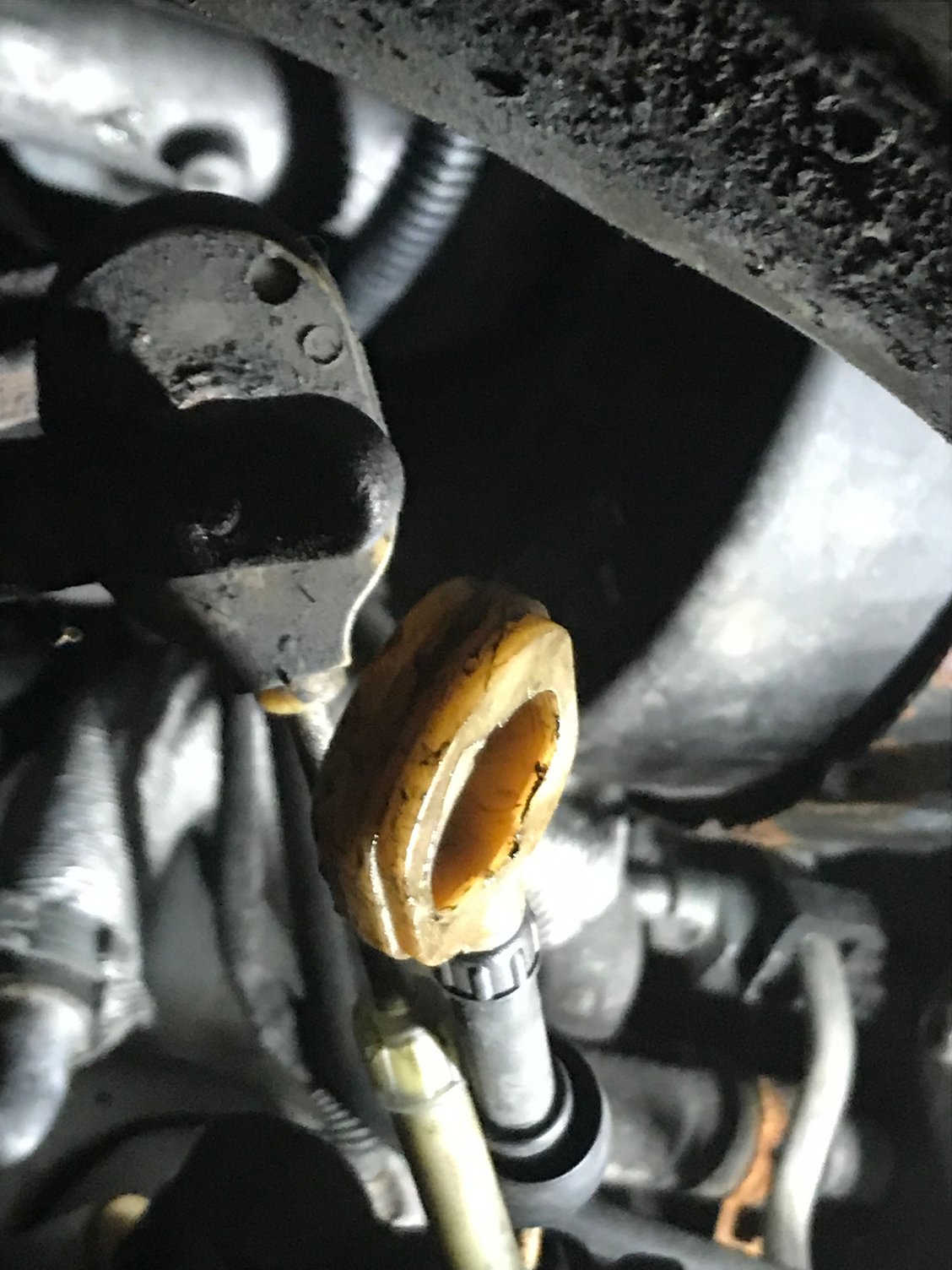

Soft Bushing with nylon cup that snaps on to transmission bracket
Cable end (Transmission end) with bushing off

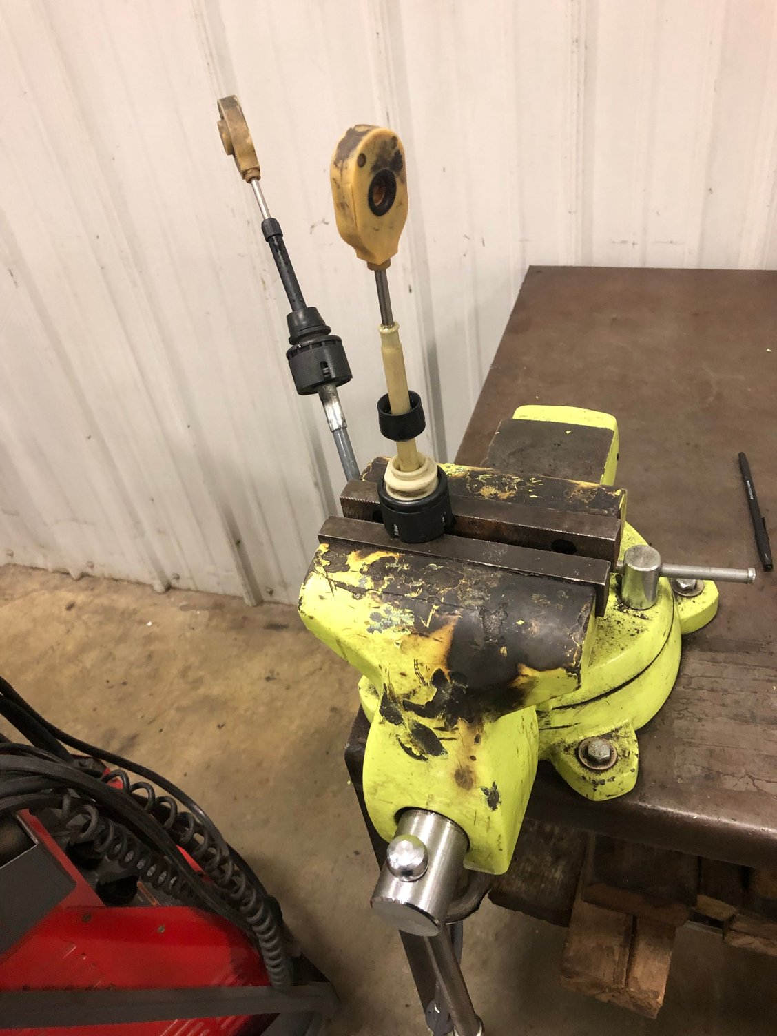

Since it was just the bushing that was not snapping onto the ball of the tranny bracket, I sourced a local junkyard and found a 2005 Cobalt SS with the same end bushings which I split the middle where the rubber was fused together and pressed it out. I then did the same on my HHR and used some industrial silicone to re-fuse it together. It is pressed on quite tight without the silicone but it’s extra measure to do so... Going on 2 weeks and it shifts beautifully.....I’m still on the lookout for new cables, even took it up with GM Canada without success.

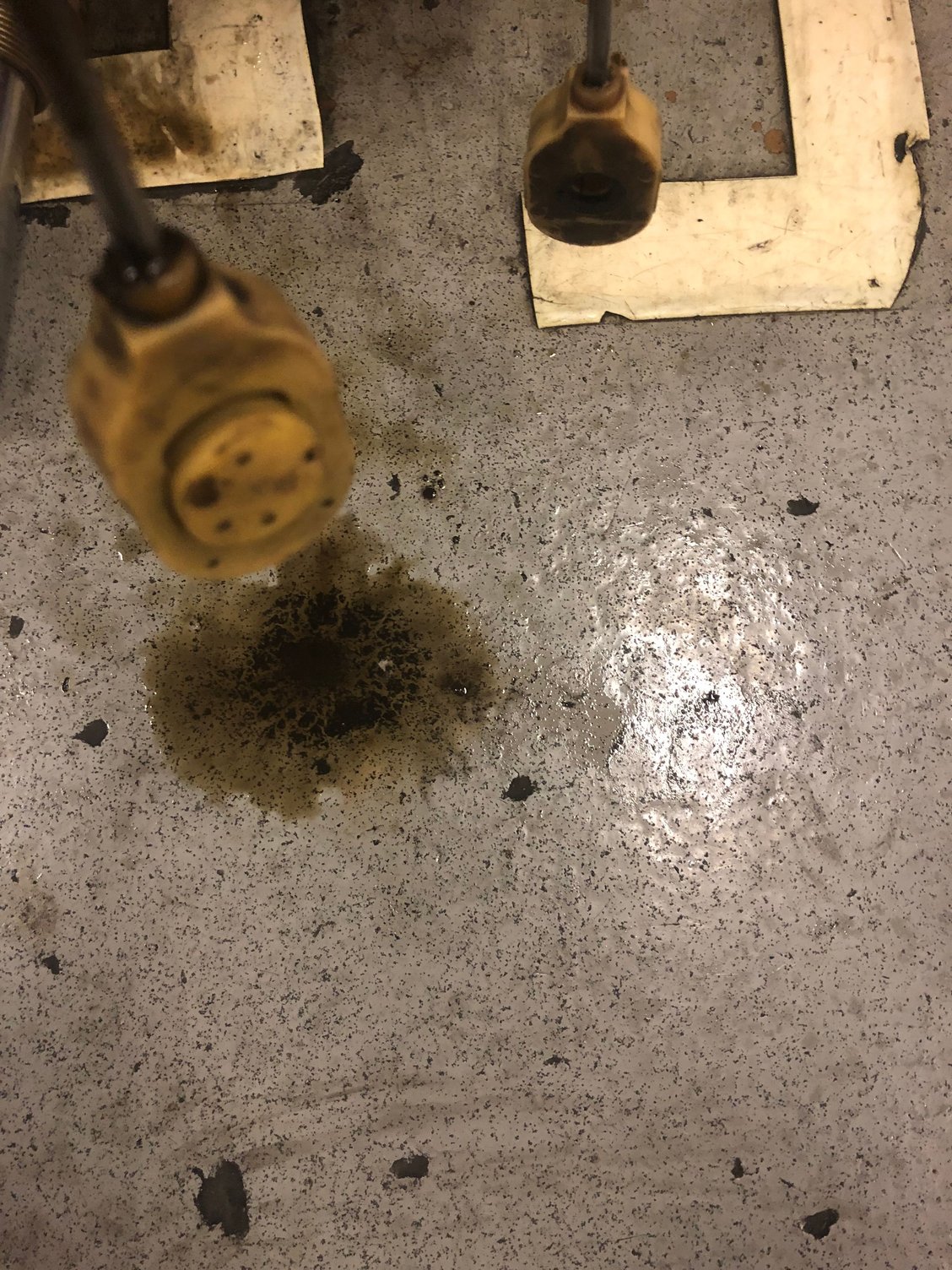

What we found when we removed the cables from the car was that the cable that would select which portion of the H- pattern you were in was next to impossible to move. It also appeared that it was built without seals on the ends of the cable. We started soaking it with penetrating oil and moving it as much as we could. At the end of the day, we could almost move the cable to the limit of its travel in both directions. The next day I continued applying oil and working it back and forth. Figured out that if I went from the shifter side, the retainer formed a ‘cup’ around the movable portion of the cable so I started filling that up with oil and working the cable back and forth to get that oil into the outer jacket. After several applications, I started getting what looked like dirt on the transmission end of the cable. I continued applying oil every 10-15 minutes, then stopped to do some paperwork and came back to this dirty puddle of oil on the floor. Cable is 100% freed up now and has been reinstalled. The car shifts great. Still keeping my eyes open for a replacement set of cables but thought I would share my experience here in case anyone else is having a similar problem.
