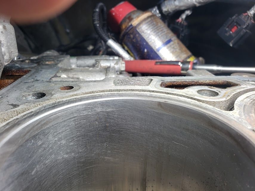

Old May 1, 2025 | 12:05 AM
  #70
antbriggs's Avatar
Joined: 08-30-2024
Posts: 23
From: Hebo Oregon
 Aluminum Transfer on Cylinder wall Before<img src=" class="post_inline_image" data-size="855x641" data-src="https://cimg1.ibsrv.net/gimg/www.chevyhhr.net-vbulletin/855x641/20250428_183049_01_e73f877041c49d41b30c908f03ad613812ea7e28.jpg" loading="lazy" />
After my Scotchbrite and Acid trick! Took Some Major effort but I'm almost there:) you can see some small traces still....Barely:)
