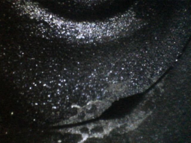

So you're thinking the oil drips into the cylinder, then the compression blew it out the spark plug hole. That's a lot of oil, the guides and seals must both be shot. Oil is not pressurized there.
Or maybe the rings/piston are broken, and the squirters are pushing pressurized oil into the combustion chamber.
Do you have any history on the car? Has the oil consumption gotten progressively worse, or was it sudden?
He is a mechanic that has had a hard time. Nornaly he's spot on with maintenance . he said when he got off freeway the car lost power and smoke started out the exhaust .
He owned his own repair shop but he's stuck in bed for now. So he couldn't really check it over.
But said car used little oil typical for the newer pcv systems .

Old Jun 18, 2019 | 04:45 PM
Posts: 11,721
That one's dead. Time for another engine.
Look down through the sparkplug hole. Wouldn't be surprised if you find a hole in the piston.

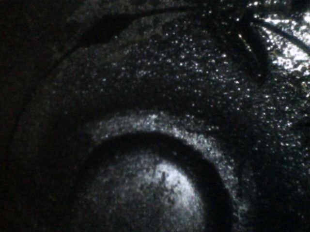

Oddly enough I put a engine scope in the cylinder and I can't see a hole. Going to rip head off tonight.

Found the hole in the piston
Found the hole in the piston.

Posts: 40,082
Yikes , come on now, y’all thought I’d say Holey Cow!
Anybody , out there have any usable LNF pistons .
Helping hand , I know our pal hellshotrod has many used HHR’s he’ll part out , I’ll send him a PM
