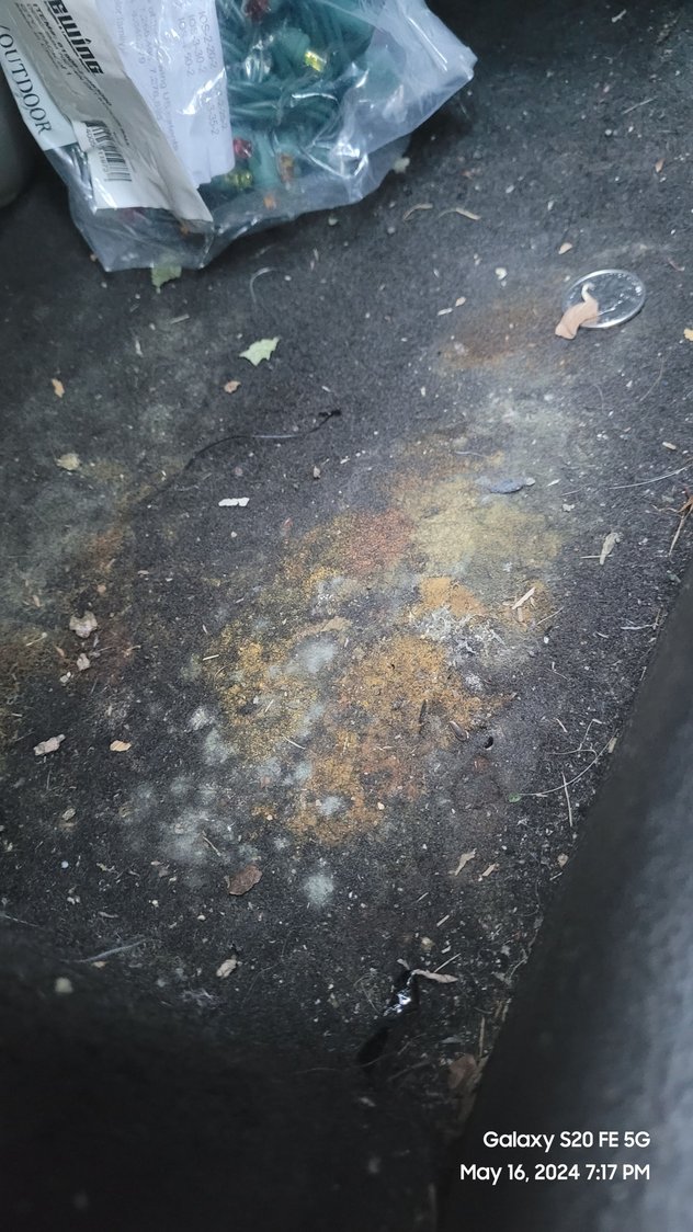

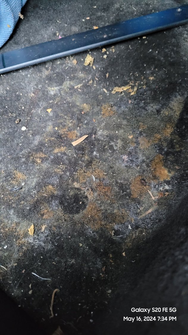

Mold on back foot area
Both sides...
Is this indictive of anything?
Do I just spray bleach or what?
Anyone ever just remove all the carpet? Lol

There are alternatives, bleach will really make the carpet ugly.
https://www.steamyconcepts.com/blog/...e%20a%20paste.
Old May 19, 2024 | 05:22 PM
Posts: 11,721
Spraying bleach on black carpet. What could go wrong with that !🤔
Honestly, I can’t believe you would ask that. 1st thing is to fix the leak. Water is coming from somewhere.
2nd, you’ll need to pull the carpet and paddings out to dry it and underneath it.
3rd you need to get some type of carpet cleaner that has mold inhibitors in it.
4th, has that thing ever been vacuumed ? Pretty disgusting looking.
