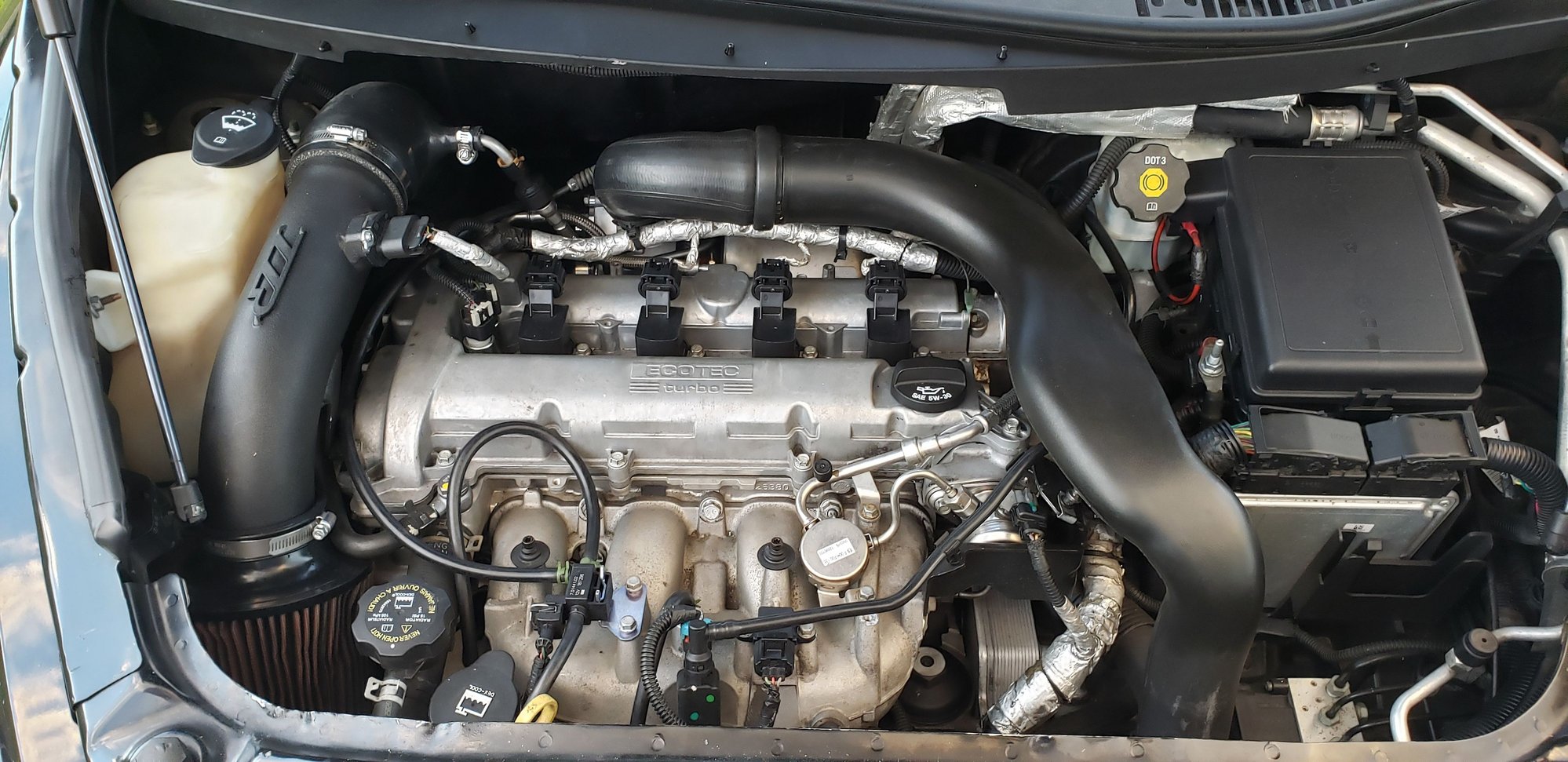

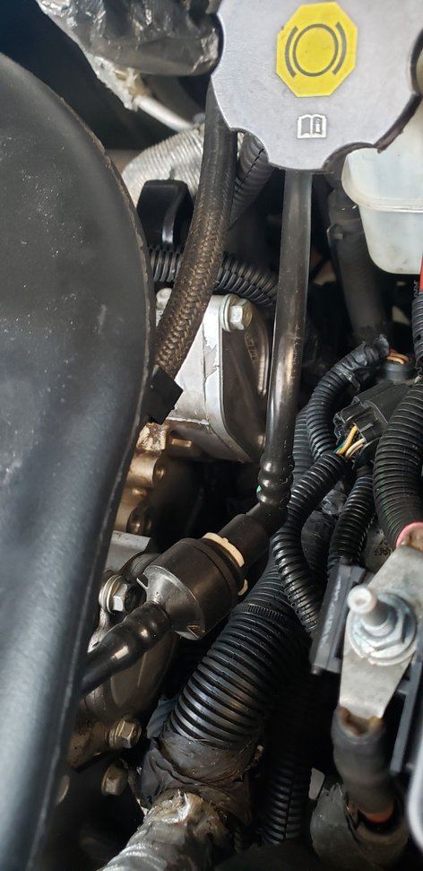

Heres a pic of what I have and trying to understand more of.
This little zzp plate I thought was a egr delete and since it does not have egr what is this plate for?

Well, you have a ZZP warm air intake.
That plate in your 3rd pic, I think you have a new(at some time) LHU/LDK engine. That looks like the block off plate that ZZP installs where the Buick Regal has a vacuum pump.
