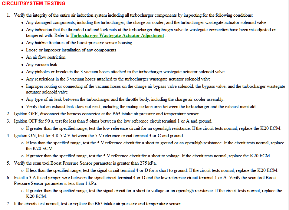

Old Apr 5, 2019 | 07:36 PM
Posts: 26,532
From Mitchell OnDemand:
