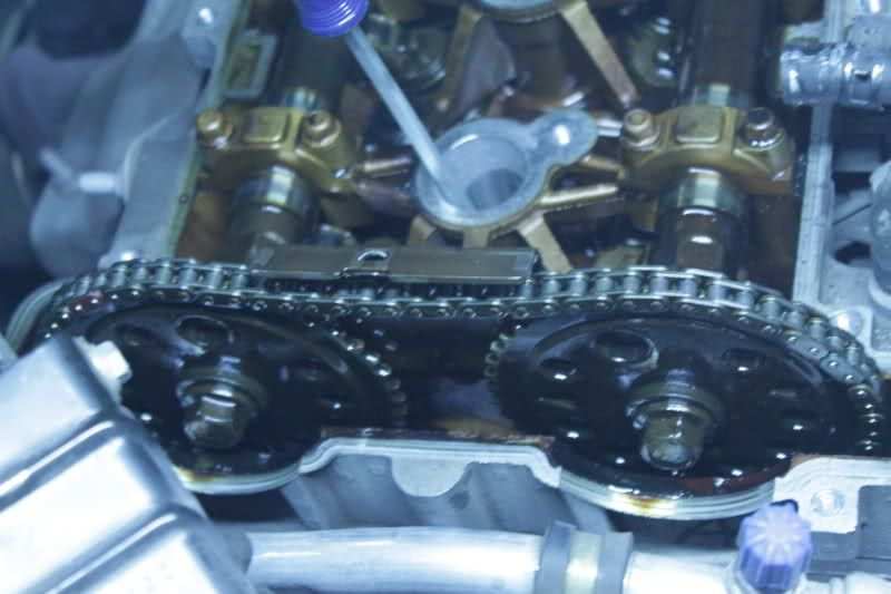

2.0 or 2.4 or even later 2009 2.2 with VVT
https://cimg6.ibsrv.net/gimg/www.che...74c56c4b9.jpeg
2.2 2006 thru 2008 no VVT, gears are different. <br/><br/>Now I want to be corrected if I’m wrong but websites tell me even a different part number

RJ_RS_SS_350 Apr 20, 2018 04:09 PM
[I]2.2 2006 thru 2008 no VVT, gears are different.
Is that timing chain too loose?
