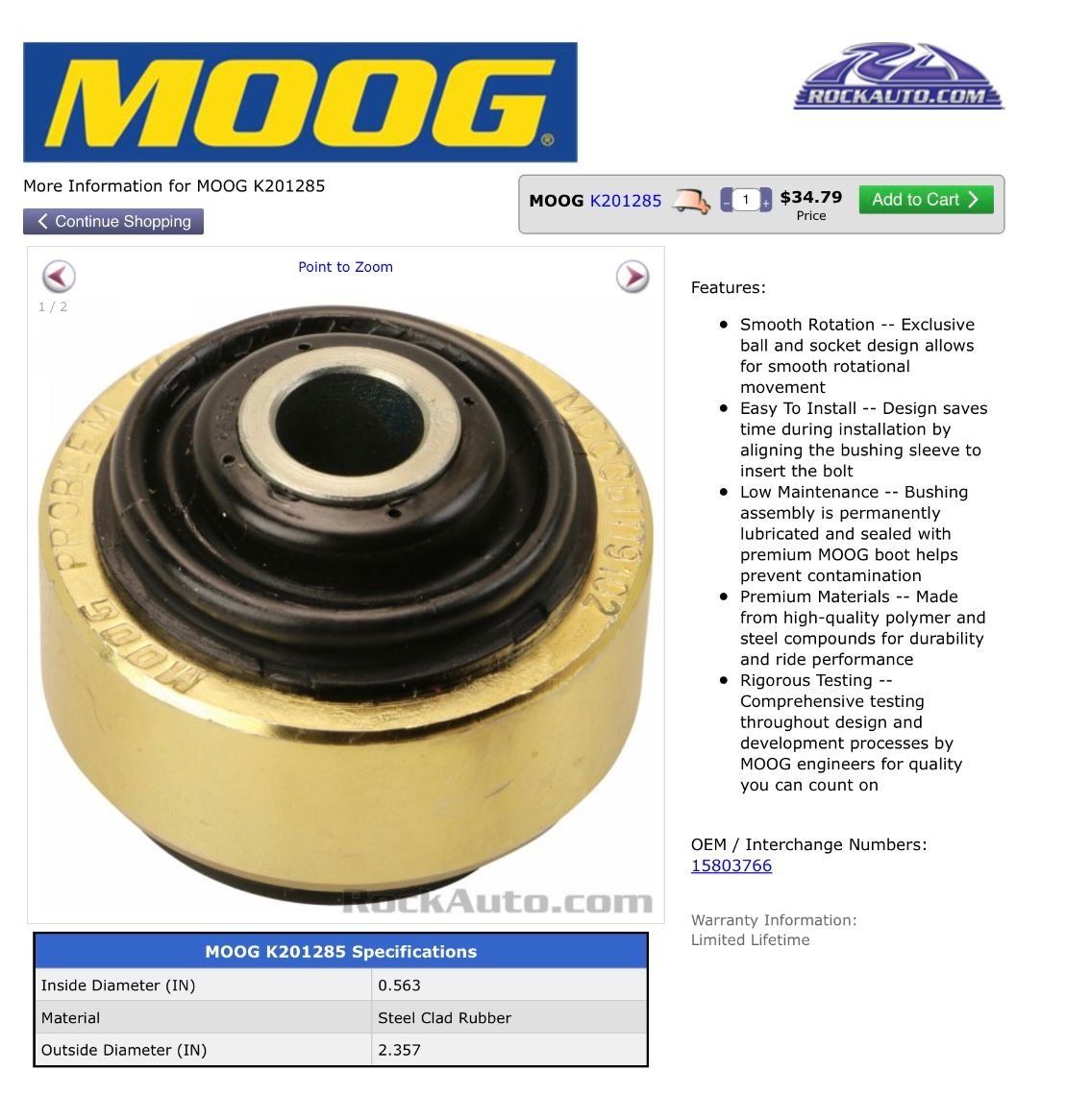

Yes, my rear bushings are completely shot; I thought it would be simpler to replace the entire control arm…
Possibly. The available ZZP control arms will include the standard type rear bushing. Replacing the rear bushings gives you options and will likely cost less.
The standard rear bushing is a rubber flexture between an inner and outer steel sleeve. Some of the aftermarket replacements appear to be of poor quality and fail quickly.
ZZP offers what they call a “solid” bushing to differentiate it from some OEM bushings that have slits to lessen flexing stress, but are suspected of being less durable and/or too flexible for optimal performance.
Moog offers a “Problem Solver” substitute that replaces the rubber flexture with a spherical plain bearing (“ball-and-socket”) and adds rubber grease seals. (Two versions, actually. The gold-colored K201285 is best for installation in aluminum.) OTTP offers a similar one. These offer more precise steering and most accounts these are more reliable and durable, making them popular for high-performance and competition. The downside is they offer no give or dampening like the rubber does, so the suspension can feel harsher, and any noise due to other loose parts might be worse.

QUOTE=Rocky1974;954478]Yes, my rear bushings are completely shot; I thought it would be simpler to replace the entire control arm…
ZZP offers what they call a “solid” bushing to differentiate it from some OEM bushings that have slits to lessen flexing stress but are suspected of being less durable and/or too flexible for optimal performance.
Moog offers a “Problem Solver” substitute that replaces the flexture with a spherical plain bearing (ball-and-socket) with rubber grease seals. (Two versions, actually. The gold-colored K201285 is best for installation in aluminum.) OTTP offers a similar one. These offer more precise steering and most accounts these are more reliable and durable, making them popular for high-performance and competition. The downside is they offer no give or dampening like the rubber does, so can feel harsher and any noise due to other loose parts worse.
I ordered a pair of those, Thanks

My posted links in post #5 and 7 allow you to select the correct ball joint stub diameter. The ZZP LCAs are not offered with the Moog bushing bearings.
