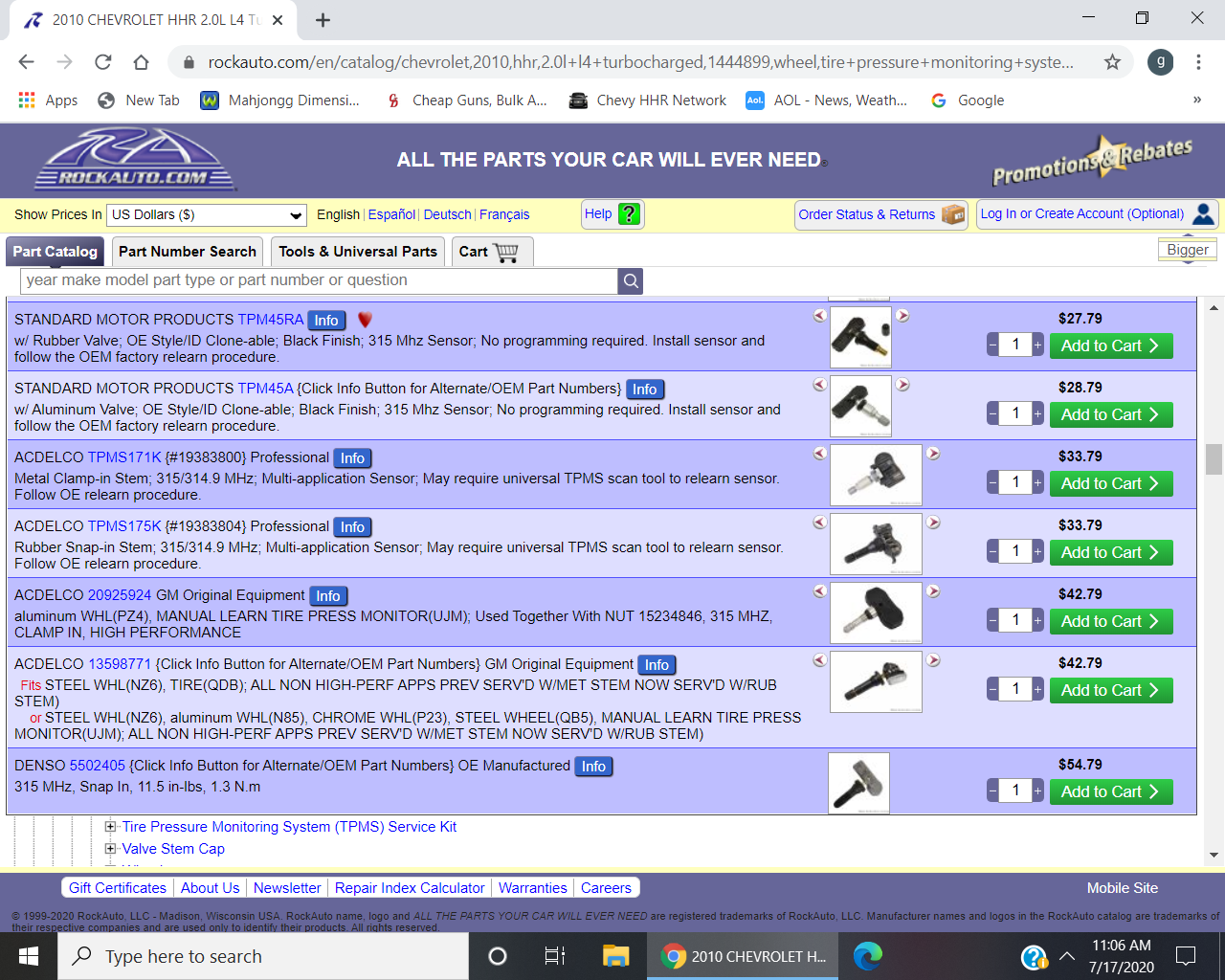

OK folks. Need a little help on this.
I need to buy a set of TPMS sensors for my 2010 SS with the stock rims. Have done a little searching for the parts but I'm finding all sort of mixed info and prices.
Have any of you SS owners here bought any lately ? If so, can you post some accurate part numbers for the metal stemmed ones the SS needs.
Thanks.
Edit: This is the parts listing from RockAuto

I've bought two sets so far for OEM wheels and aftermarket.
The AC Delcos I scored from buying from Walmart, believe it or else.
The second set I bought off of Ebay.
Both times used the Delco part number for the SS sensor.
Here is a Ebay ad and if you scroll down you'll see the OEM part number.
https://www.ebay.com/itm/2008-2010-C...QAAOSwlfxXGRo2
If it's a metal stem with the correct frequency (315mz) buy them.

19383800 are for your SS aluminum rims
https://www.rockauto.com/en/catalog/...)+sensor,12036
https://www.gmpartsgiant.com/parts/g...-19383800.html
I check other sources, Walmart.com only had one left, was a few dollars more.
Tasca parts and Summit Racing were more money also .
My RockAuto link comes up in CDN so I don’t know the exact amount, but remember the discount code!

I think my originals are closer looking to the 20925924 GM original equipment ones listed. Only problem with those is they don't come with the nut.
Guess you can just reuse the old nut(s) ?

I found the look of the sensor doesn't matter.
The Mz does.
You can reuse the old nuts as long as the new valve stem has the same tread size.

FWIW, I purchased the VDO SE10001HP REDI-Sensor 314.9 MHz/315 MHz sensors in 2017 after doing a little research across various brands. My tire guy was reluctant to install other than OEM sensors; he said they rarely are able to calibrate aftermarket sensors. I had him install anyway. The VDO sensors calibrated first time without an issue and have worked great ever since.
