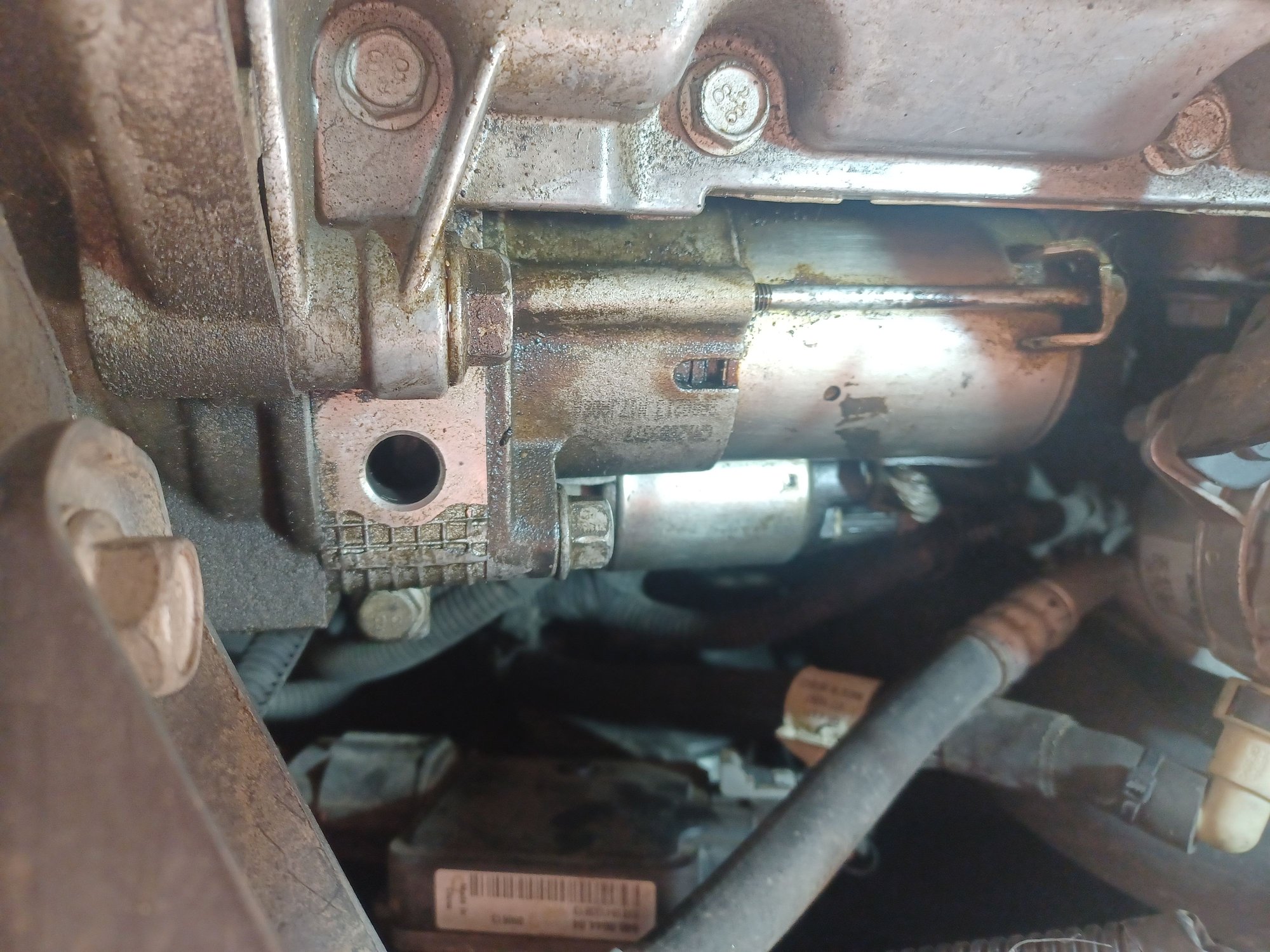

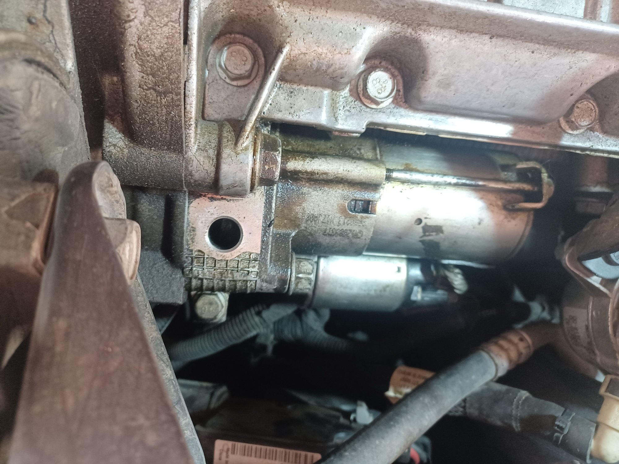

Starter pics
Old Sep 3, 2024 | 07:57 AM
Posts: 26,532
Those long bolts are part of the starter, not the mounting.
Old Sep 3, 2024 | 08:11 AM
Posts: 11,721
Not the best angle for the picture. I think I can see the vacuum pump that I mentioned earlier. It appears to be on the right edge of the pictures.
If it is that pump and it is in the way of the starter, then you’ll just need to remove it to gain access to the starter.
Would be nice to see that pump from a little further away. Just to confirm.
