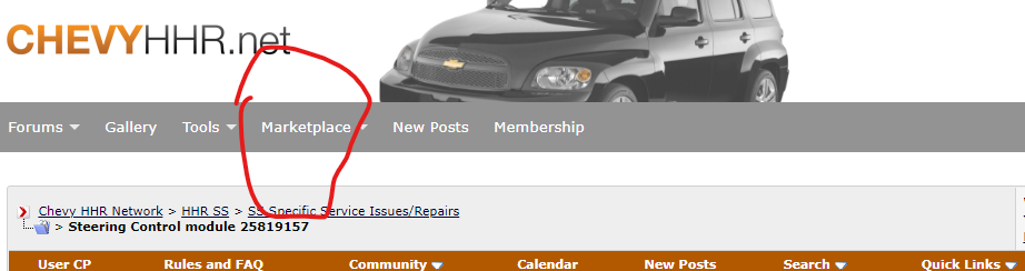

A. Why do you think you need one? I have never heard of one failing.
B. You should post "Wanted" in the marketplace
