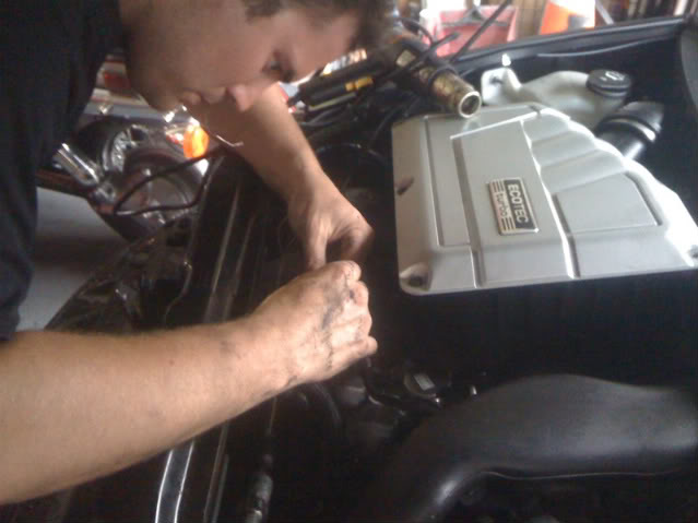

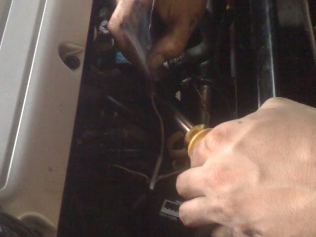

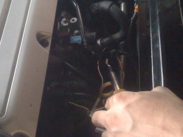

Hello everyone,
Well i finally got around redoing the connectors on the ss. Ill have to say what a difference!!!!! The ss dose fell like its missin or when the a/c is on not shaking the car. As soon its stop rainning ill have to see if performs better. I like to thank my buddy Erik at lashway who did the soldering for me.

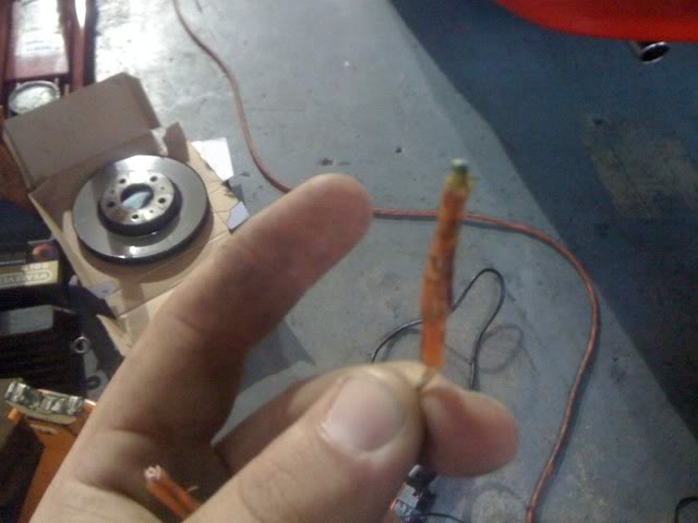

CRAP!!!!!!!!!!!

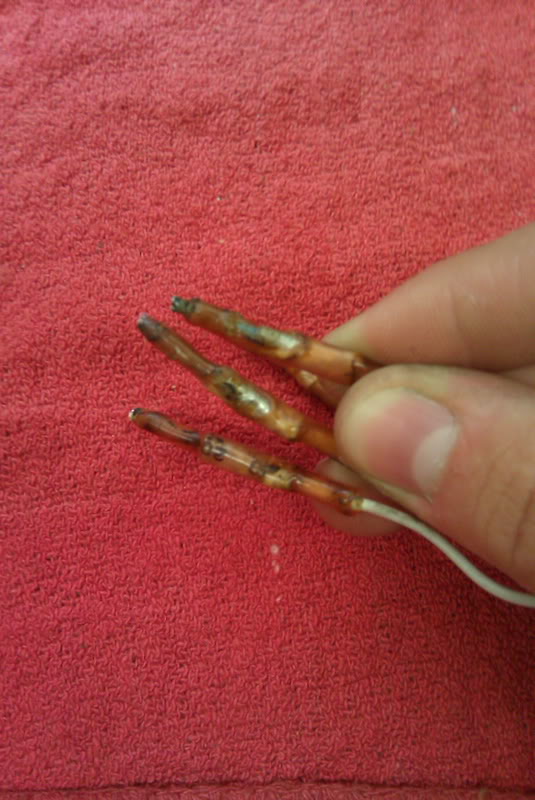

looks factory

Thanks for looking.

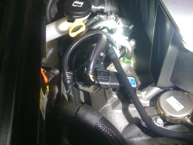

That's the easy one. What about the lower TMAP???

I got to see the lower one while mine was up on a lift at the dealer. Talk about a difficult location!!!
I hope your friend has small hands.

If you disconnect all the connectors on that section of harness (where the lower TMAP is) you can pull it out from underneath the car. It's a lot easier to solder that way.
The insulation was melted by the dealership and then they taped the butt splices together. It didn't work out very well.

The reason for soldering the connection on my car was to correct/prevent possible shorting since there was bare metal showing.
My connections are not air tight, but I don't drive my car during winter or when it's raining (rare ), so I'm not worried about it. I'm sure the connectors the dealer uses would work great if they applied less heat since they are sealed.

Mine were starting to show the bear connector and who ever did the kit twisted the wires together, so as soon the bear wire would touch another connector it would short out. So redoing the connection the car has ran alot smoother since when I first got it. As performance goes I get better thorrtle response since I have done the top so when I get a chance I'll do the lower hopefully before my road trip.
