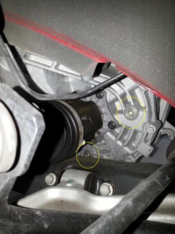

Not sure what 3 bolts you're talking about. Here's a picture of my SS 5 speed drivers side axle. I count more than 3 bolts on the seal retainer plate. Maybe you could be more specific about which bolts you think it is.
(disregard the yellow circles. They just show the drain and fill plugs )

The upper yellow circled item in fireman's pic is where you would put your finger in to check the fluid level inside the tranny. As you can see, a little more than half of the plate you are concerned with is below that fluid level. It is quite possible that the gasket for that plate is leaking.
