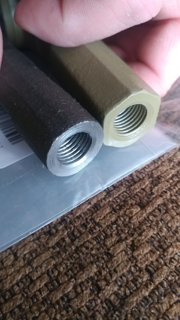

Now compare them to the FE5 tie rod ends from your car.

Fit like a glove!
How tight does the nut need to be? Do I need to grease them?
