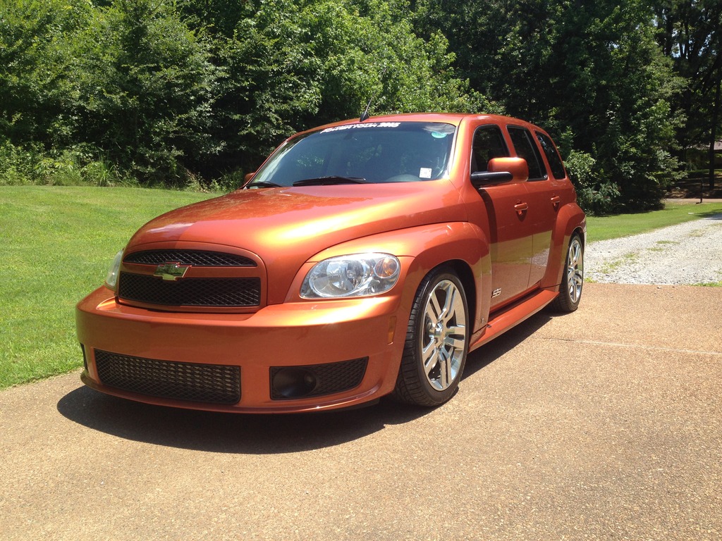

Term2 has calmed it down to my taste. I ran the Hot Rod Power Tour and got 29.4 mpg over 1375 miles. It ran 13.41 at Memphis in 95 degree heat spinning tires to 300 ft. 15lbs in 1st gear then 25 to 27lbs. it's just about the most fun you can have with clothes on.
