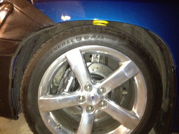

I have 8" wheels with 255x40x18. fits fine. The offset is 40 on our cars. Haven t really noticed the small brakes. But if that bothers you, you can always switch to brembos...they stop a lot better.
I think you mean 18".......
Old Apr 12, 2013 | 12:37 AM
naw, he means 8 inches wide on his Solstice rims.

Hello all! New here and needing some info. Question for SS fan. First off the rims are awesome. Just got a set for my 07. Need to know how thick of a spacer you used to fit those 255's on the front. And if you had to get longer studs? Any help would be appreciated.
