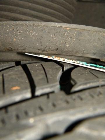

Yes I have mounted a 235x45x18 on stock SS wheels. I would have lost the 100.00 to the Discount tire Mgr, it was His idea. We put them on 08Banshee's SS, He loves them, awesome all season tire. I will be buying a set for myself, soon as I wear a little more off these Gmax03's. 40k and they still have 5/32nds.
http://www.tirerack.com/tires/tires....omCompare1=yes
Here is what they look like.

I tried the DWS in 245x40, they lifted in deep water, it happens here a lot. The gmax have been the softest, quietest tire I have tried, but they were the 255x40. 40k plus and they are still quiet and handle the deep water. The DWS does have monster traction, I swear they ripped the rocks off the road. Check out the weather at the autocross today, monsoons.......
oops clearance, they are close, but no rubbing. A little closer than these.
