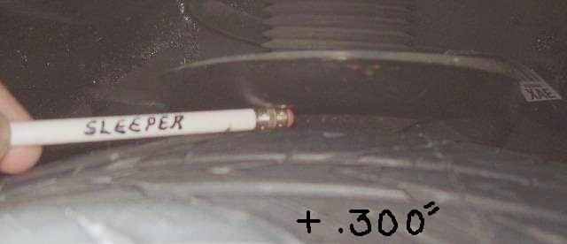

This is the clearance I have running 225/50/17 tires that are 26.2 I believe. The pencil is touching on both sides, trust me.

I can see it. pretty tight space in there.
I almost went with that size, but going by what FMG said and that calculator site I figured it would be close, and it is, but as long as it isnt rubbing :)
another size added to the list !
