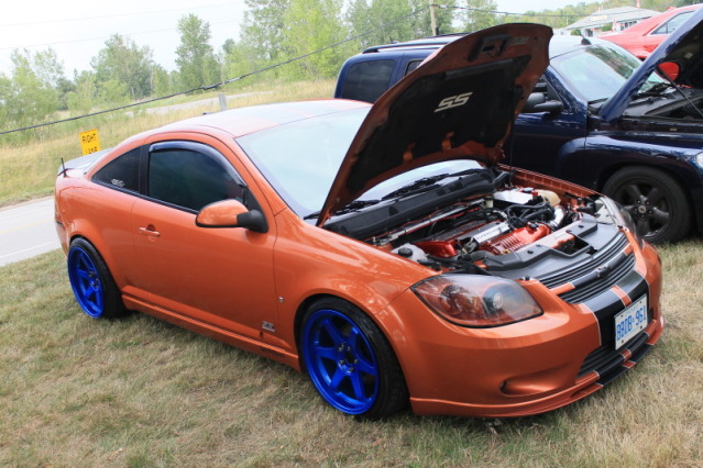

How wide are the wheels?
How wide are the tires?
I have seen that kind of offset fit, but the wheels may poke out past the fenders. The tires may have to be narrower than the wheels to prevent rubbing. A friend of mine has something like that on his cobalt. A +22 offset with 9.5" in front and 10.5" in back, so wheels are quite wide. Tires are 225 and 245.
It has nothing to do with fitment. This is just an unsafe way to mount tires where all the little kids think it's "cool" looking.
your friend's car also has a very poor fitment on his car. Just because you can do something, doesn't mean it's right.
A optimum fitment for a 245 tire is an 8" wheel and a 225 is less than that. With fitment like that, cars look absolutely horrible and are unsafe at speed.
