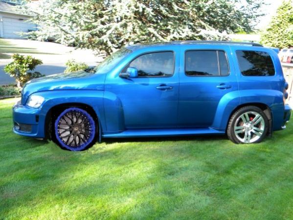

Damn son thats frosty territory for a poboy like me.
I'll prolly take "Moon's" advice, handy they come in blue you know I'm partial to blue
check out this butcher job
