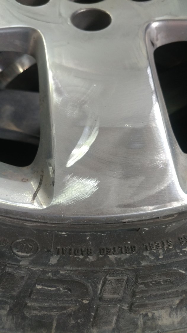

Anyone ever polosh to a brushed finish? Not a fan of the chrome look.
got these 17"s from the junk yard for $200
Seems like only the edge if the pad work and wears out pretty quick.
Old Mar 31, 2024 | 07:35 AM
Posts: 40,083
