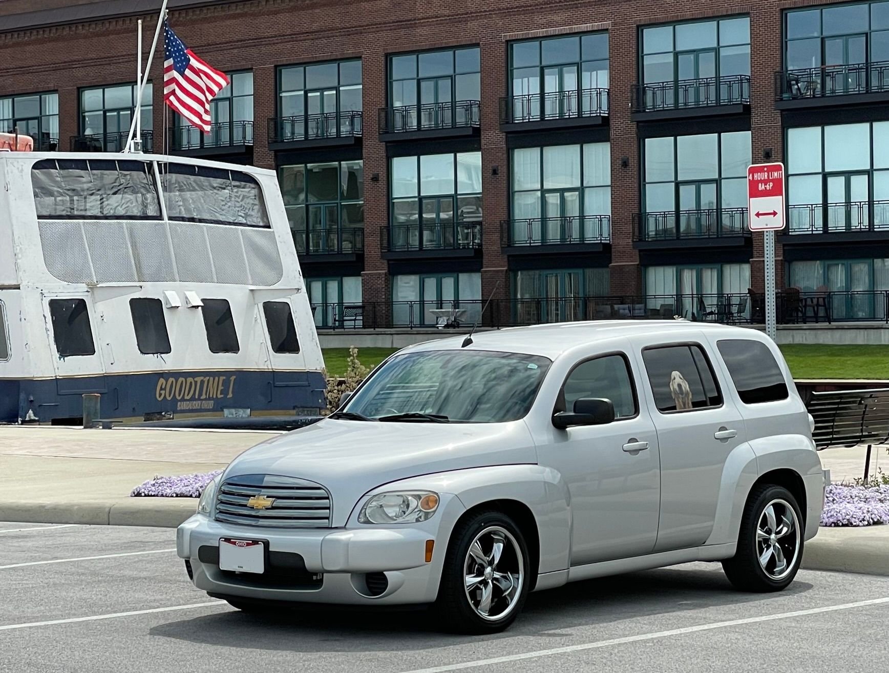

I cannot find a good looking aftermarket wheel that will clear the Brembo brake upgrade. I had American Racing Torque Thrust M in a 17" but its not even close. Need a 18x8.5" 35mm offset. Any ideas? Trying to keep the Hot Rod look vs Euro.

The pictured 17” wheels do not clear factory Brembos.
