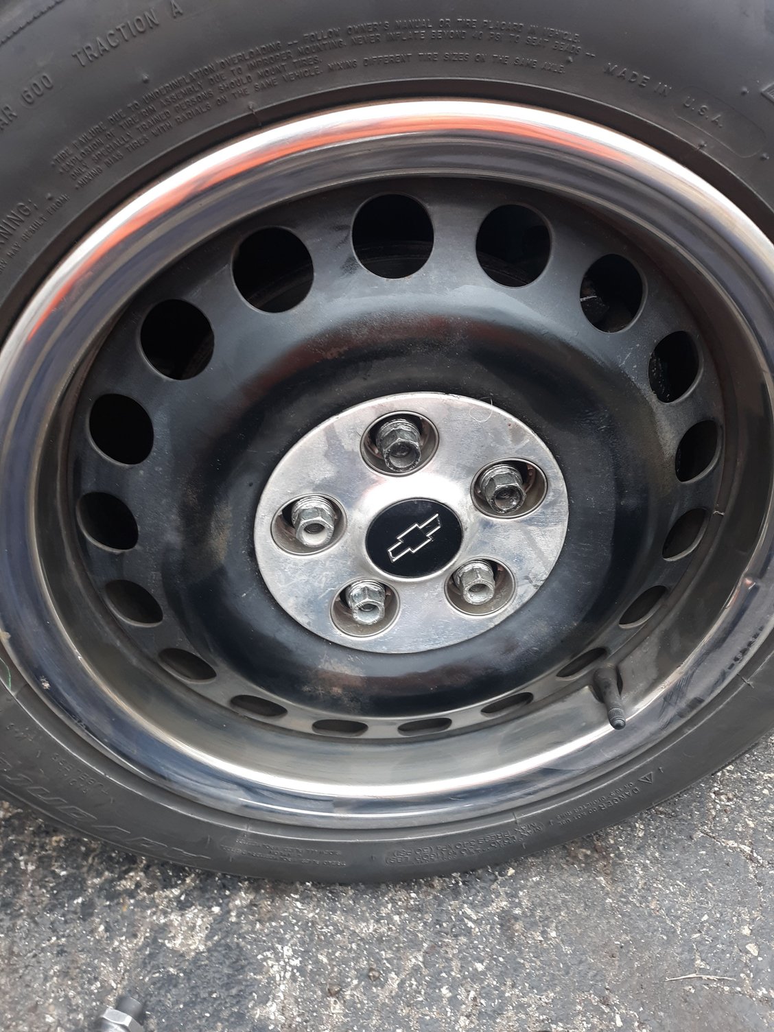

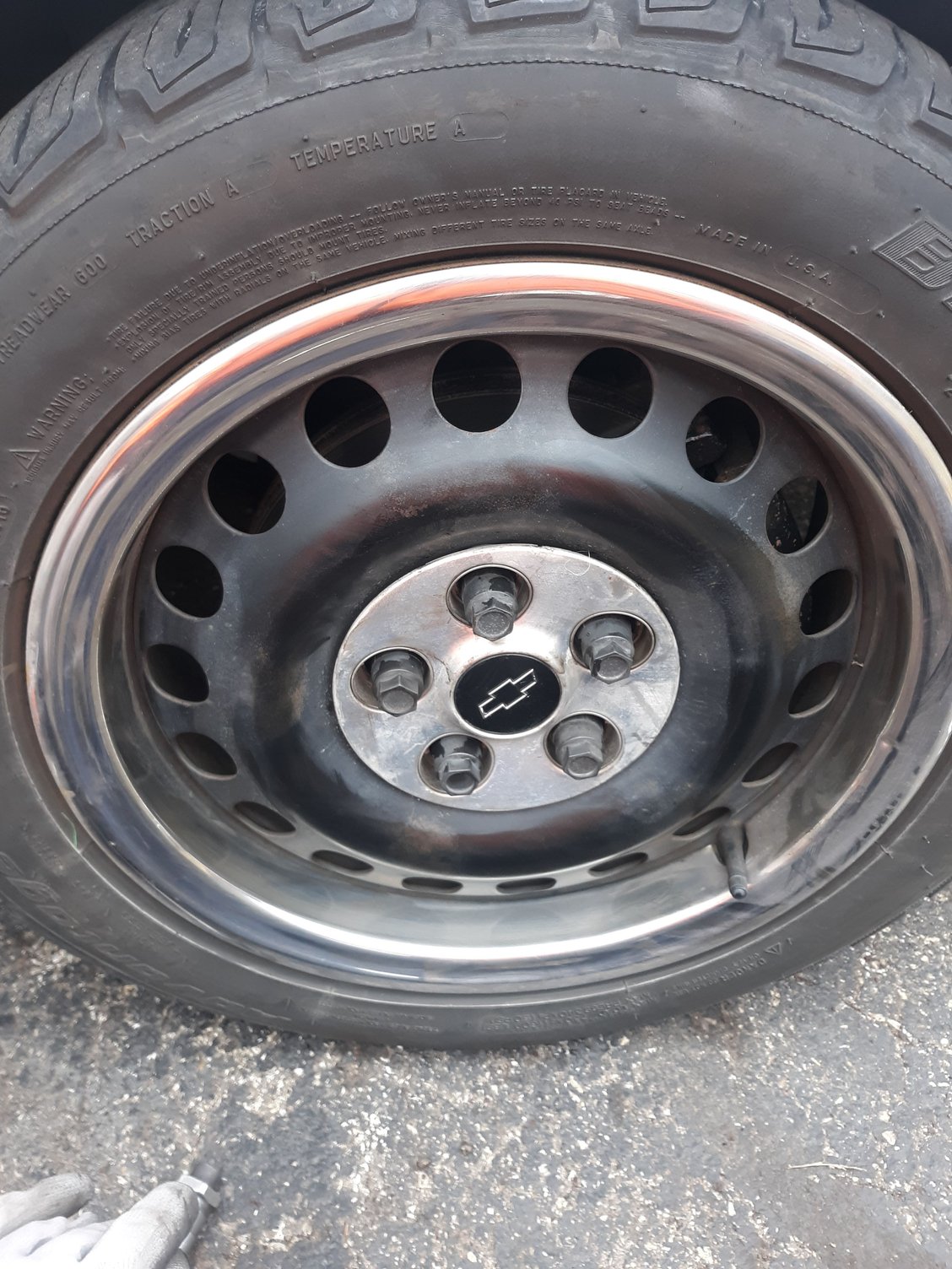

Here is my Solution:
These are the 16 inch standard HHR steel rims
I did check the center cap solution on the 5 spoke <steel> rims, but they do not fit... unless you want to cut them alot.

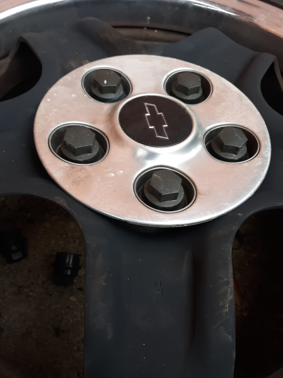

The Center-Cap is off of an 02-04 Chevy Malibu that uses the 5x115 wheel bolt pattern.
I don't have a specific part number, but the item can be identified as "chart number" 9593499, however this also cross indexes to a Saturn Vue variant. A similar cap is also available as variants that have Pontiac(silver and chrome), Oldsmobile(silver and chrome), or no logo (stainless steel) with a round knob on the center that comes off a different Saturn. All these center-caps came from the center of alloy rims and include built-in lug-nut-caps as retainers. The stock center-cap lug-nut-caps did not fit and were discarded
Lug-Nuts are standard GM threaded lug nuts, used on steel wheel HHRs, but I often find these on 06-14 impala if equipped with hubcaps.
Lug-Nut-Covers are short black plastic, they were sourced from a 97-03 Pontiac Grand Prix.
Trim Rings are from a 1990s Chevy Silverado 2500, the retaining tangs had to be bent outward to increase tension and grip. None have separated since install. I have also seen 17" trim rings on 2500 Silverados if you need such parts. These trim rings are common also on GMC and Chevy trucks and vans of the era.
The center-cap hole pattern is actually slightly large than the HHR bolt-pattern, they can not be installed with their stock lug-nut-covers. Pry them out gently and discard. With the threaded lug-nut installed you can press the cap over the lug nuts. The thread of the lug nuts will rub and grip the inner most part of the hole in the center cap. The cap will bind in place when you slip them on. However, if you want to be able to remove without removing lug nuts, you would have to trim the hole for clearance.
Last touch is the Pontiac lug nut covers, which help secure and beautify them (I do need to polish them). They do not protrude into the hole and stop at the contact surface the original nuts had a flange at.

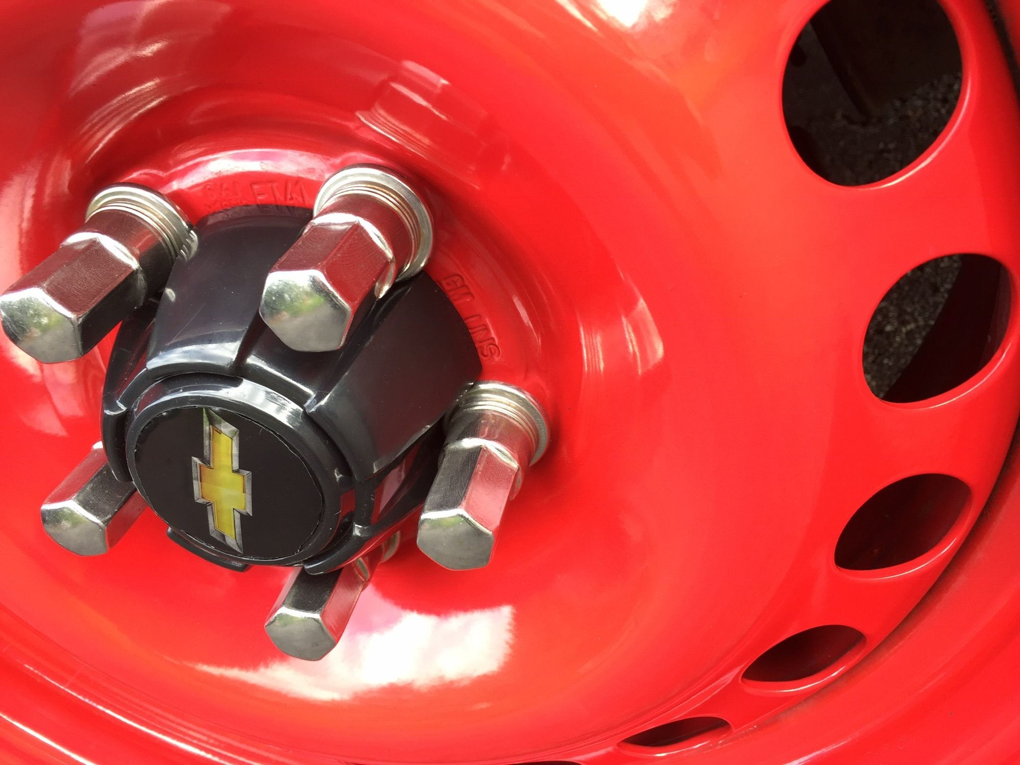

I’ve done the 16 inch steelies in red, no beauty rings
Why not white!
Still looking good the day it was picked up by new owner
Oldblue in red steely rims
Fresh from the powder coating, caps are Toyota pickup, lug nut caps are 1988 Pontiac Trans AM
The lug nut caps friction fit to hold the caps in place.
