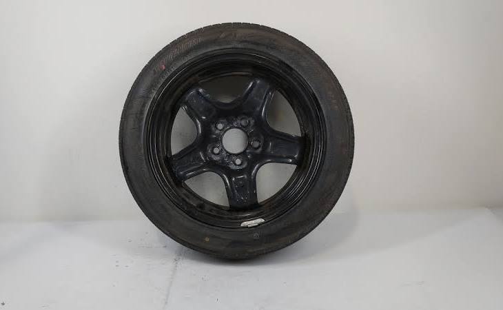

It seems that the offset for HHR's is +42 and that rims for other cars will fit. The tire size on my 2009 LT is 215 50R17. The rims are 5 spoke steel, painted black. I can't seem to find these rims specific to my car. Most of the rims I have found for HHR's are the 16 inch variety. I have found 17/7 rims that fit Cobalts and other makes but the offset is +40. Would I be able to use these rims?
Old Dec 24, 2022 | 06:51 AM
Posts: 40,083
If your look like this, those are the 1LT rims, they came with a chromed plastic cover
the Cobalt rims will fit
Yes, my rims are just like this one but have no covers.
Old Dec 24, 2022 | 06:27 PM
Posts: 40,083
Paint is a good cover! A set of nice lug nuts would be cool!
Thanks. As far as I know this should fit all HHR's even though this one is for 2006.
