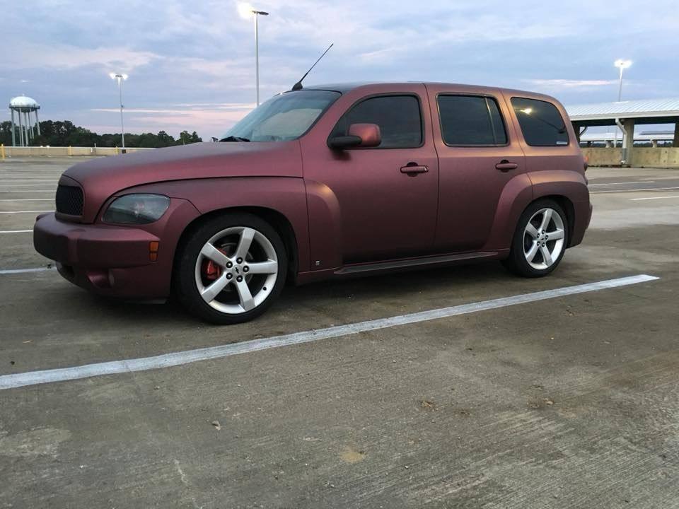

I'm a little late to the party, but YES....you need spacers or the rim will make contact with your strut. I tried to avoid them, but had no choice. I am running a set of
universal spacers from AutoZone.
I've been running these since around 2011 with no problems at all.
On a side note, I DID opt to replace my studs with longer ones (Dorman) so I have more threads for my lugs to grab.
