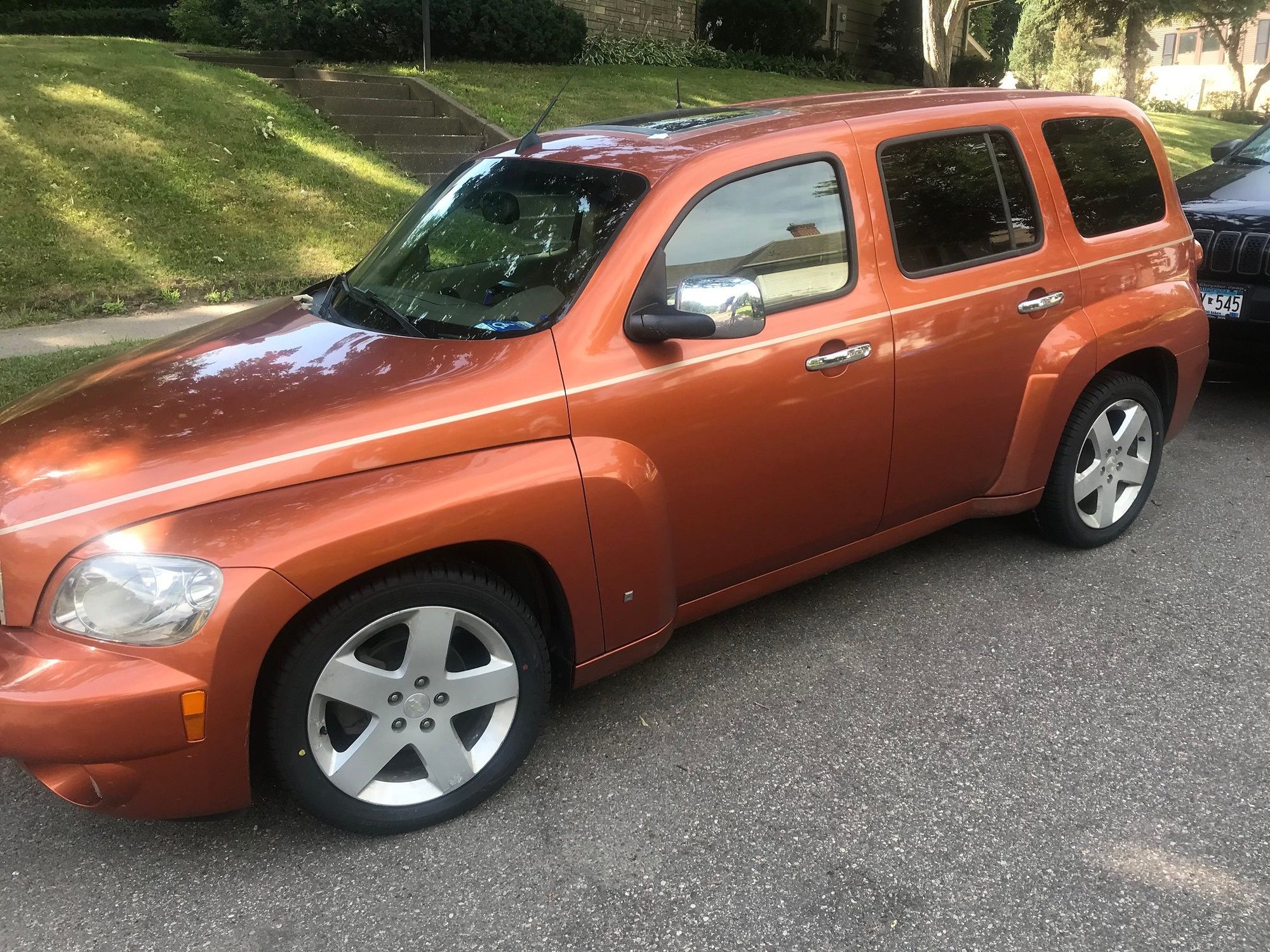

My internet has been crazy today, not a cloud in the sky so WTF?? anyhow here is the pics

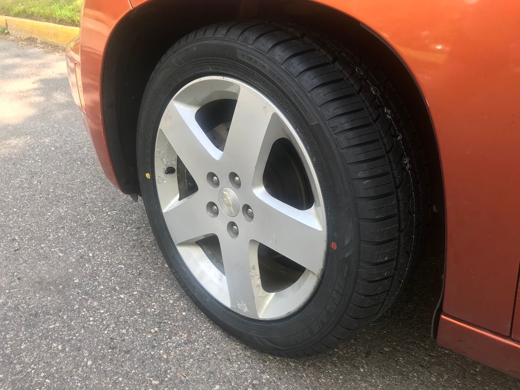

I know the rims need some work, but it is a daily driver, about 500 miles a week...

Nice! I wonder it those wheels would look either
A: gunmetal metallic?
B: matching body colour?
C: metallic silver?
the possibilities are endless, just sand them to get the scrapes and scratches feathered out .
Or the tedious job of sanding, polishing the aluminium to a brite finish.
