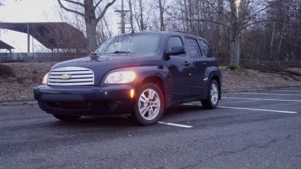

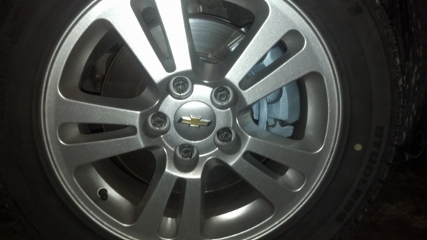

Do you mean these?
Yeah, they fit.
Old Aug 21, 2014 | 08:34 AM
Posts: 40,083
confirmed!! Thanks Frenchy. and by the way they look much better on an HHR than a Saab !!!!
