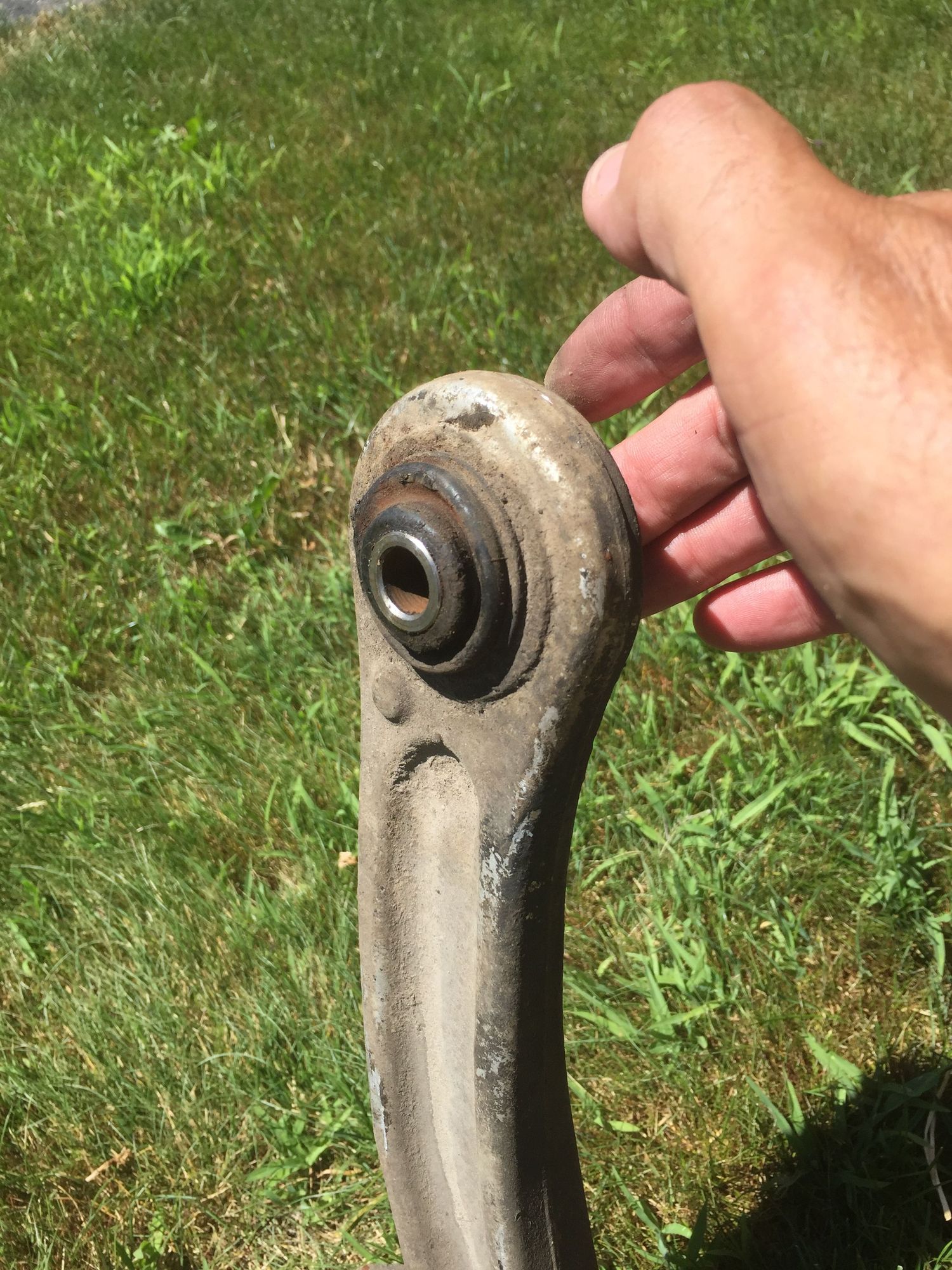

This is the top side, the bushing is pressed up and out, the new bushing presses in from this side, it has a taper or bevel to start it into the LCA, the hole has a slight bevel also to start the bushing in, I used a 1 7/8 socket and 8lb hammer to drive them home, using an old brake disc for an anvil.
