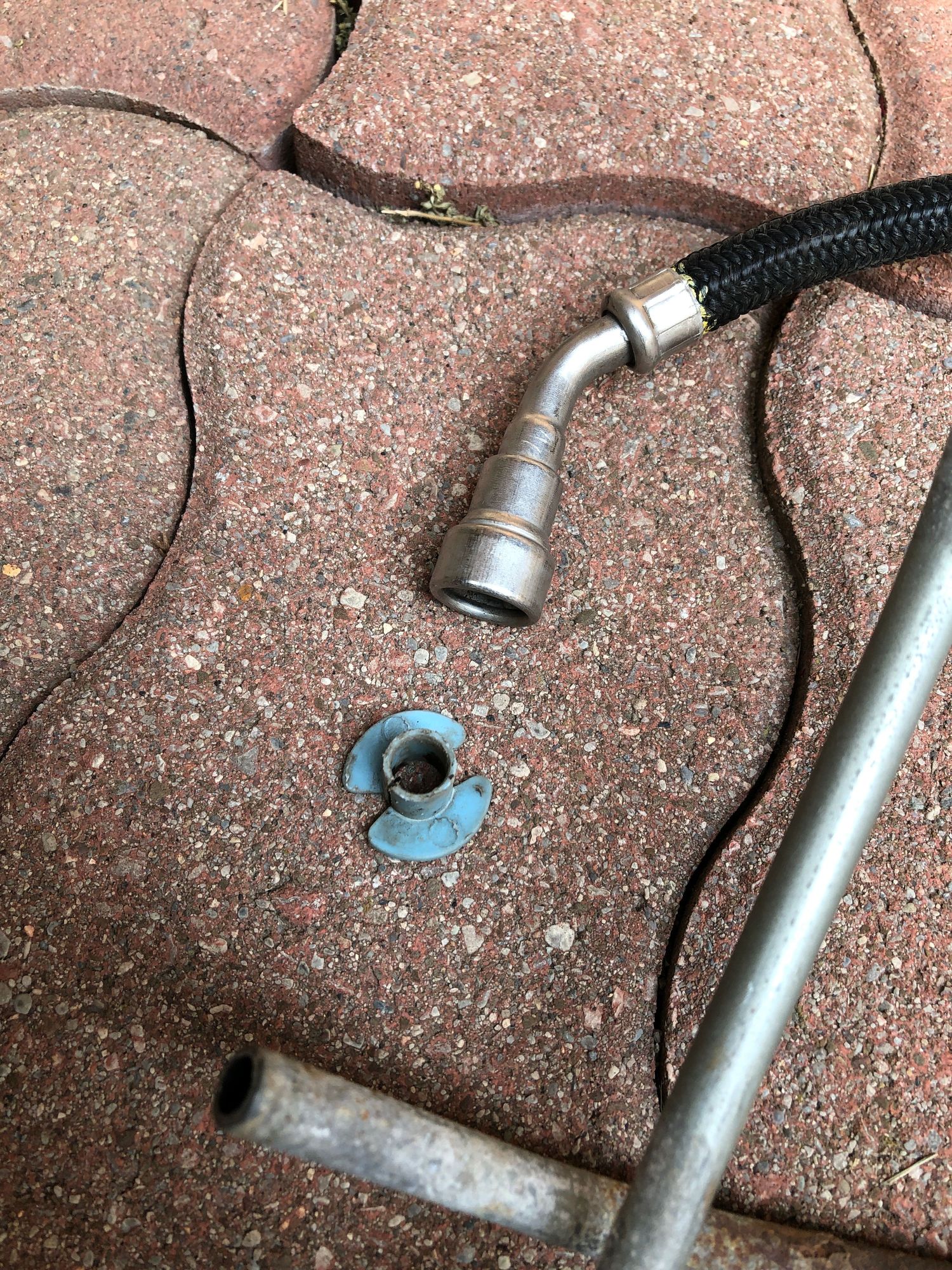

I used this 3/8’s line tool to remove the fuel rail end , gently push down, then insert the tool and push into the fitting a slide it up and off the pipe
