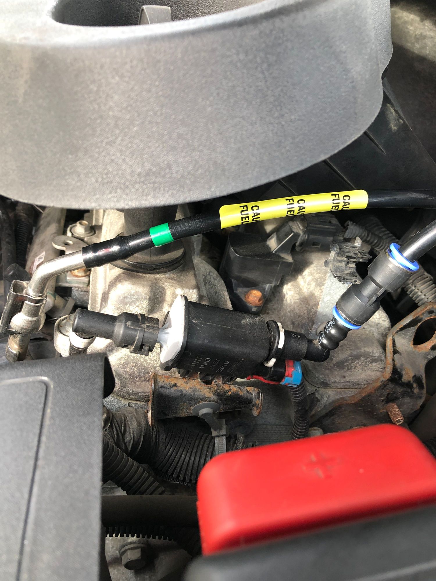

Up under the hood , I routed the new lines up to the fuel pie on the fuel rail and connected the fitting, then the vapour line , the instructions tell you to cut the old line an use the supplied coupler in the hose , that piece with the blue rings.
