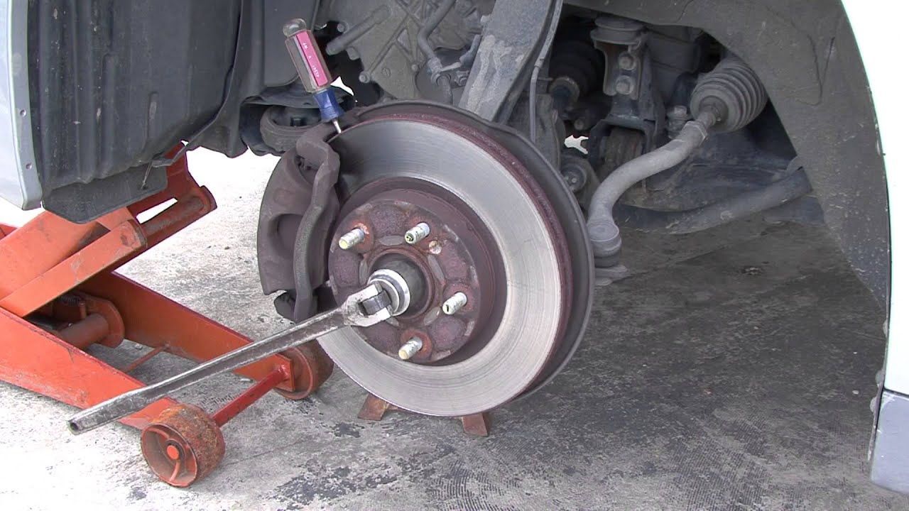

Note the Craftsman screw driver at the top of the brake caliper. I know this isn’t an HHR , but the principle is the same. And if you need more leverage , slide a pipe or floor jack handle over the end of the Johnson bar.
