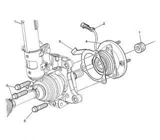

Part #5 , you will need to remove the axle nut and the three hub bolts , then re torque the three bolts to 85 ft/lbs and the axle nut to 155 ft\lbs the brake caliper bracket bolts are 85 ft/bs the caliper bolts are 25 ft/lbs
