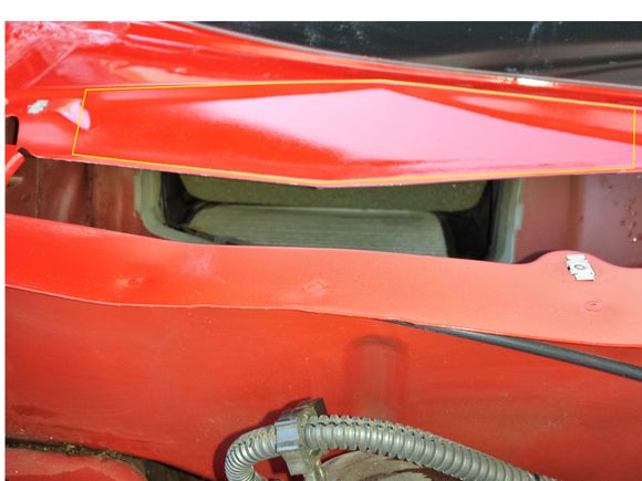

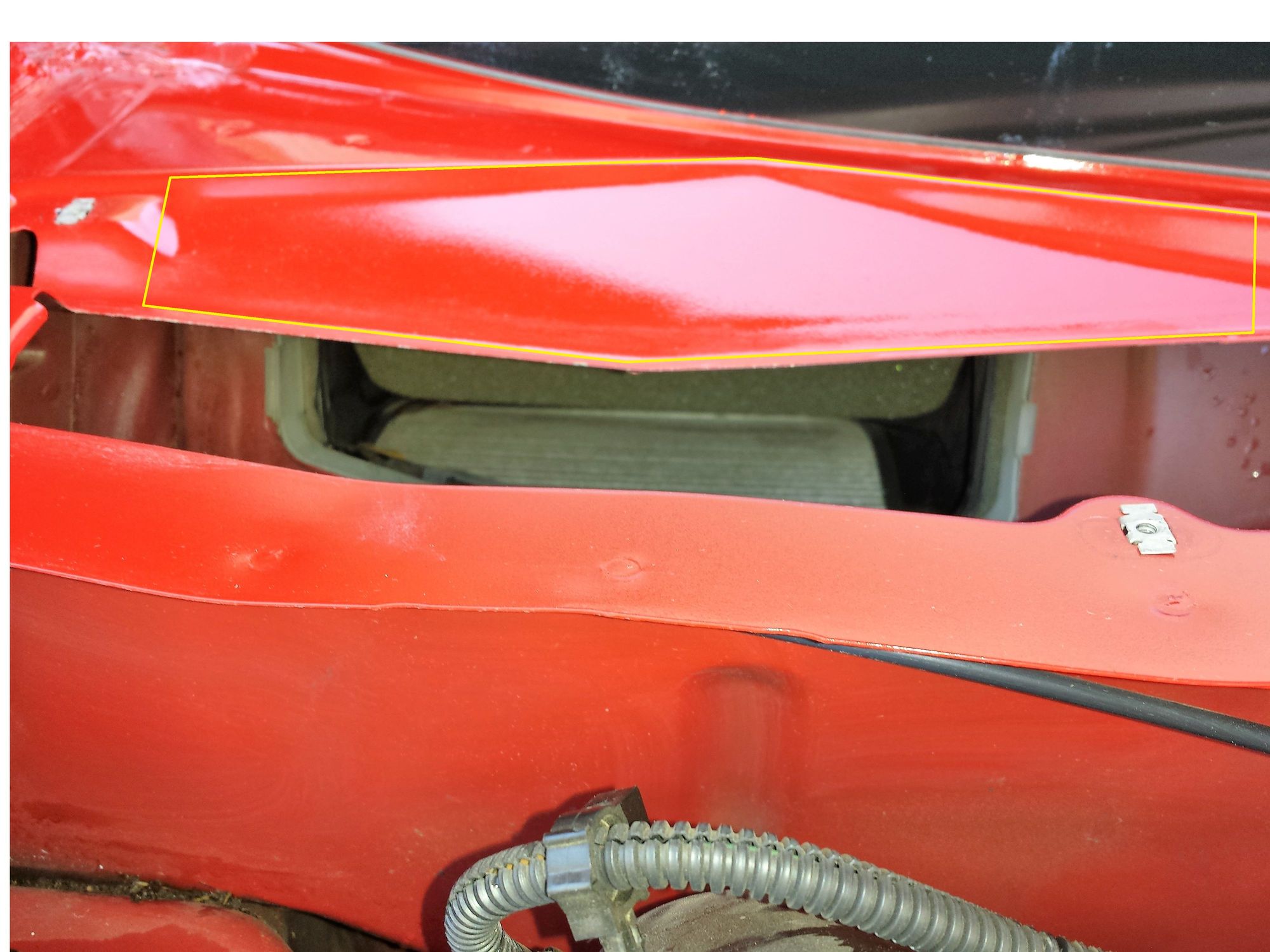

This is a 2010, but the same as 07 thru 11 model years, note the difference in the shape of the holes. There is a drain hole in there, pull the wiper cowl cover and check it
