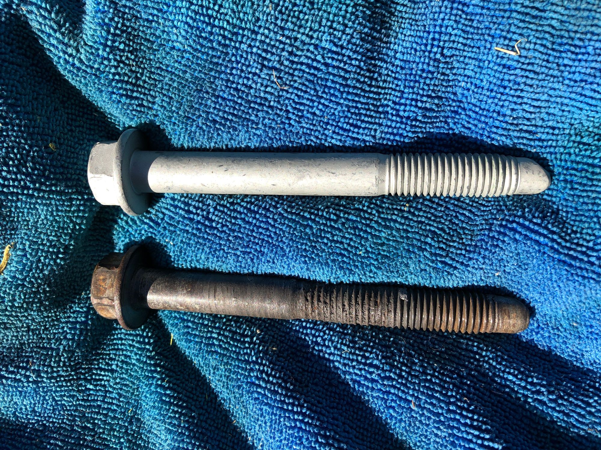

Bottom bolt, note the middle of the bolt is thin due to the stretch of that extra 180 degrees of torque, while the top bolt has it’s shank in the same area, so grease or anti seize them well!
