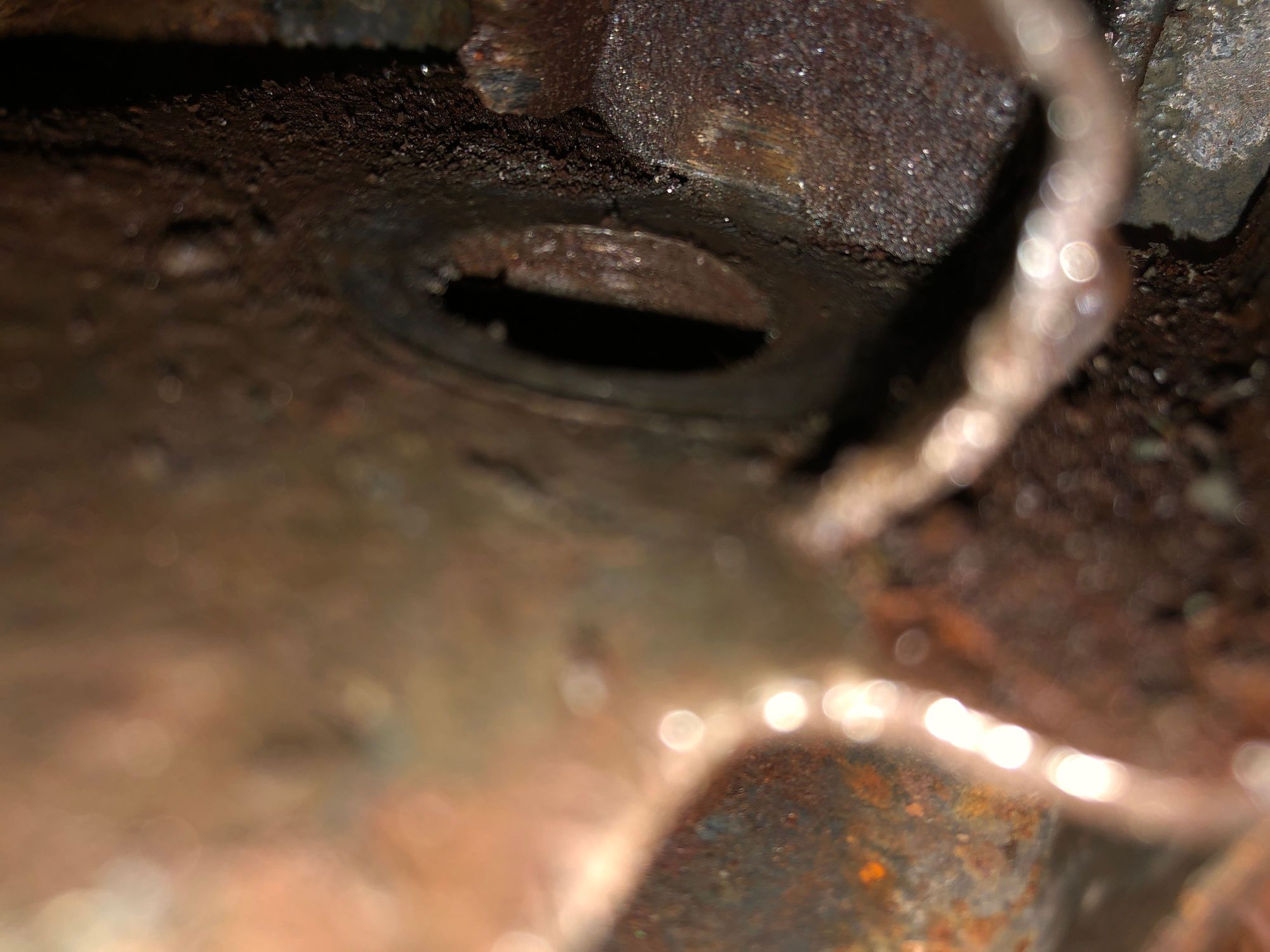

This is where that cage nut lived, it’s now occupied by the new cage nut, I managed to get a smaller pry bar in there and straighten out the front side of the cage , that held the new nut from spinning, so I could torque and turn that new bolt 180 degrees.
