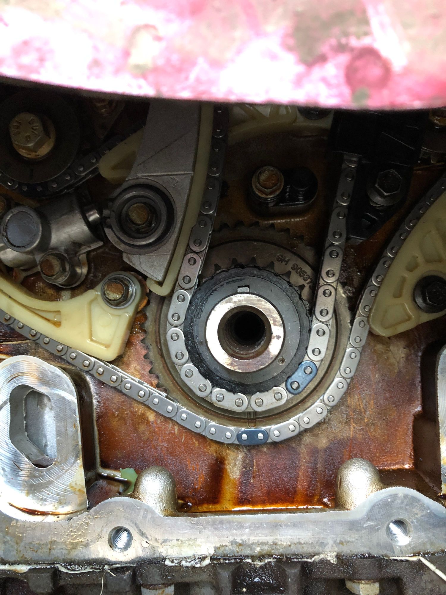

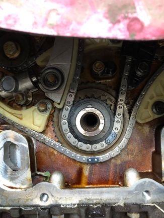

Ensured the timing chain was in the correct place , then installed the tensioner and gave it a smack to engage it, That took up all chain slack!
