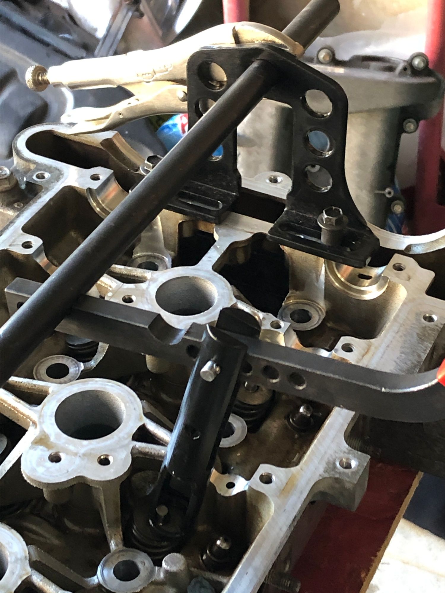

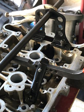

Used this handy tool to compress the valve springs then remove the valve keepers Then installed new seals and valves and used the tool again to reinstall the keepers
